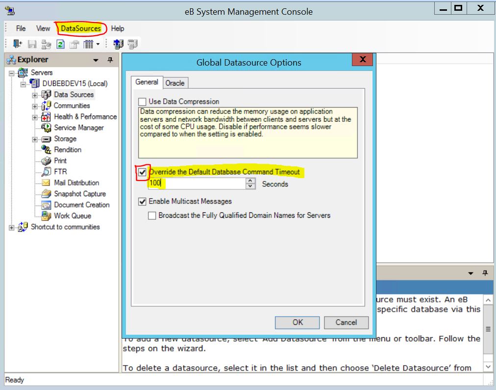

Work Around :
Above error can remove by increasing Default Database Command Timeout in Seconds
- Select "Data Source" tab from menu bar in SMC and select "Options..."
- Select "Override the Default Database Command Timeout" and increase time in seconds from "Global Data source Option"
- Select "Ok" button
