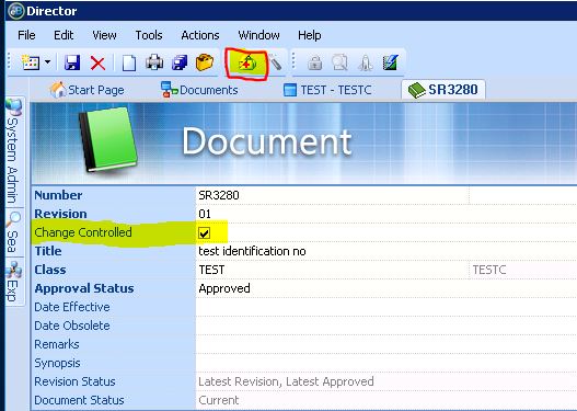

1) Open approved object for eg : Document which is under change control
2) Select "Add change request" button from tool bar and add the change request after filling mandatory fields.

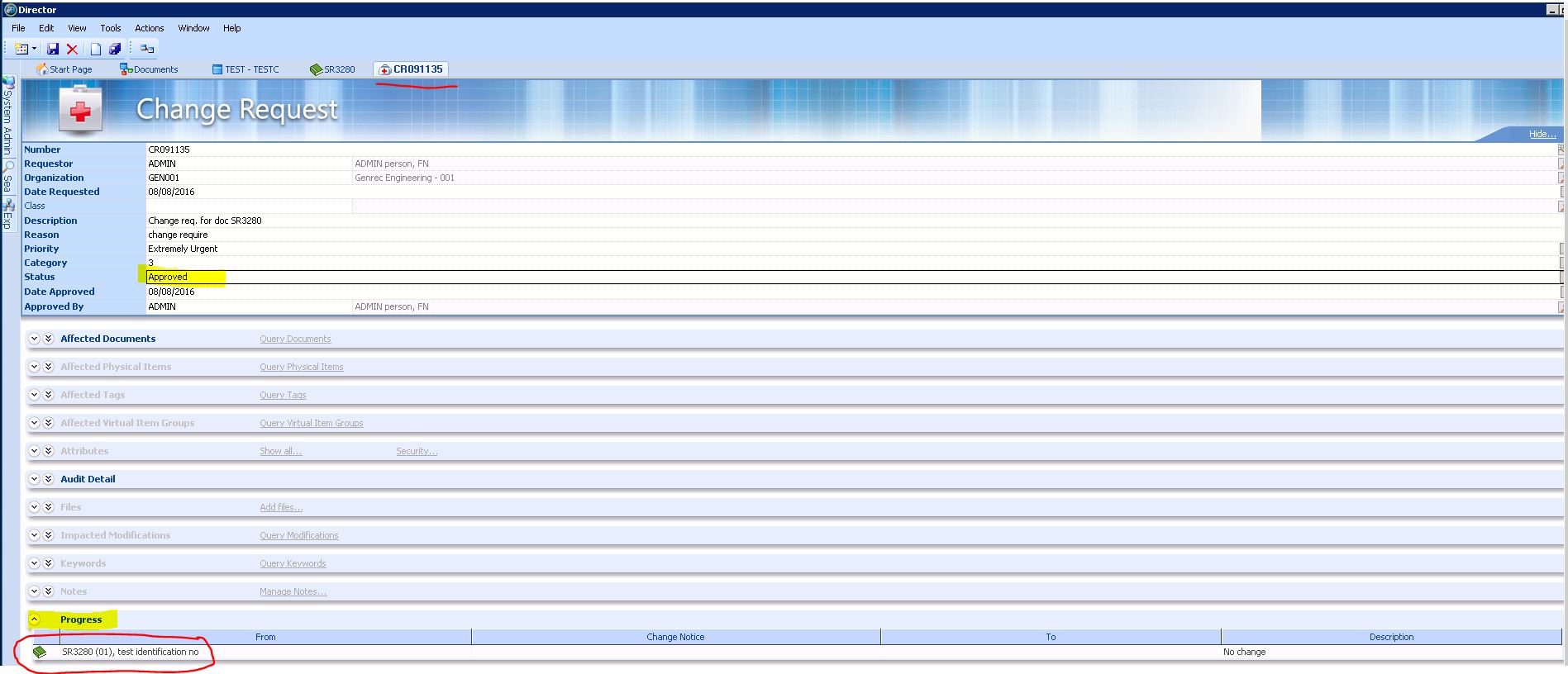

3) Approve change Request (change status from draft to approve and mention field approved by)
4) Expand "Progress" topics under Change Request - you can see object(Document) under change control. Double click on object to open it.

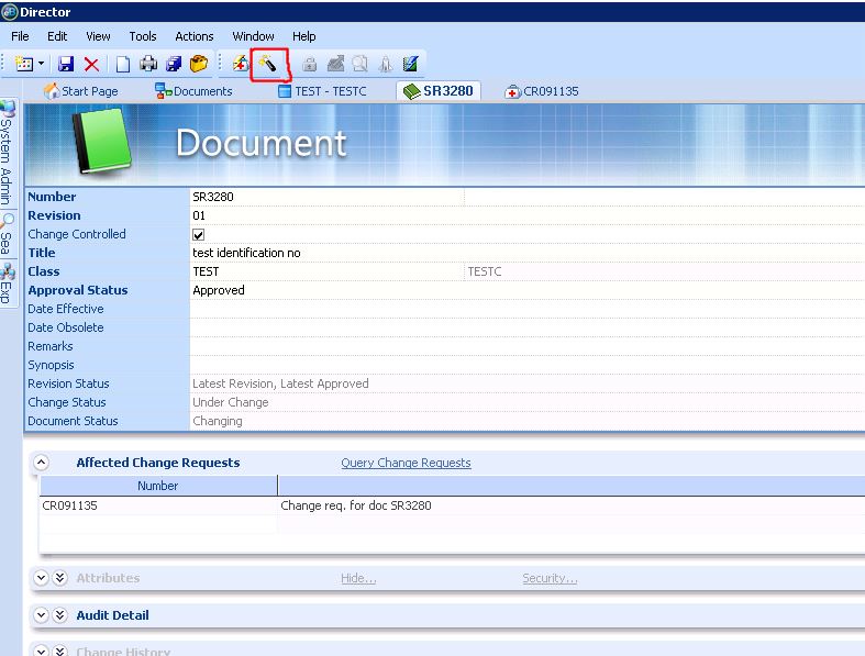

5) At top, tool bar you can see active button for "Implement Change". Click on button to implement change request, give revision number, set action to implement and create new revision
6) You will notice that new revision of object has been created with Approval status as "Not Approved" and here you can make required changes and save it
