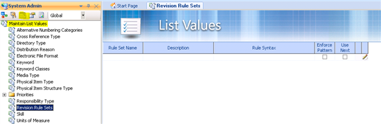

Revision Rules can be set through the eB Director within the Maintain List Values section of the System Administration tab in Director.
Revision Rule Sets has following fields which is defined in the below table:
