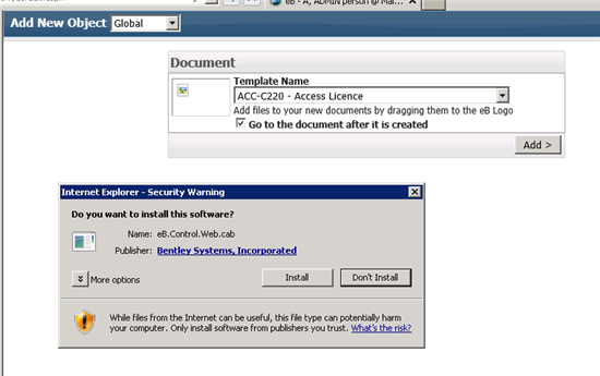

Active X is installed on users’ pc only when users opens eb Web, opens page where Active X is required and Accepts ActiveX installation from prompt screen (screenshot below).

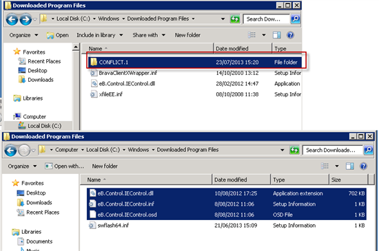

 Location where Active X is stored Windows\Downloaded Program Files (sometimes it is stored under Conflict.x folder).

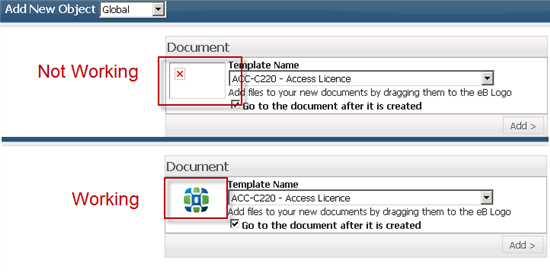

How to identify that ActiveX or Web Client Components is not working: Open Create new eB Object or any Not Approved document and if you are not able to see “Turtle sign” It means that ActiveX or Web Client Components is not working and you won’t be able to do any file handling operation.

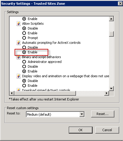

3) You are not prompted with installation message in IE and you don’t have ActiveX installed make sure you have correct settings set under your browsers security settings (see screenshot below).

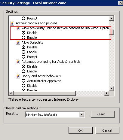

4) After installing Web Client Components make sure you have "Allow Previously unused ActiveX controls to run without prompt" Security setting for IE set to Enabled. This option set to Disabled might cause you some issues if you don't have permissions on running ActiveX components.
