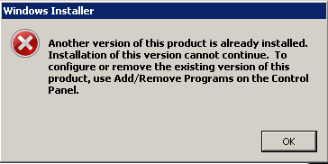

When trying to install different WCC versions on same machine error message is received “Another version of this product is already installed. Installation of this version cannot continue. To configure or remove the existing version of this product, use Add/Remove Programs on the Control Panel”.
This issue is related to Bug in installed (which will be fixed in future releases).

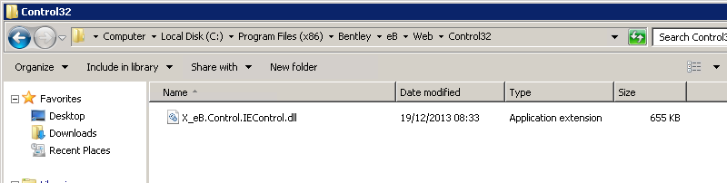

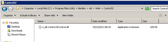

  2. Navigate to C:\Program Files (x86)\Bentley\eB\Web\Control32 and in this location rename file eB.Control.IEControl.dll (in example x_eB.Control.IEControl.dll)
  3. Uninstall the Web Client Controls using “Uninstall Programs” (as you have renamed .dll file it won’t be deleted)

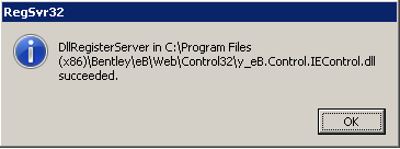

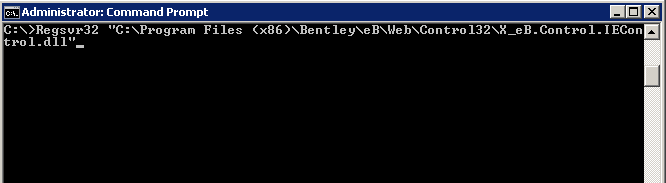

  5. Register renamed dll file using regsvr32 by running following command in command prompt window
Regsvr32 "C:\Program Files (x86)\Bentley\eB\Web\Control32\X_eB.Control.IEControl.dll"
If the file was registered properly message as in screenshot below should apear
 Note(if you have renamed your file differently then don’t forget to modify regsvr32 command)
