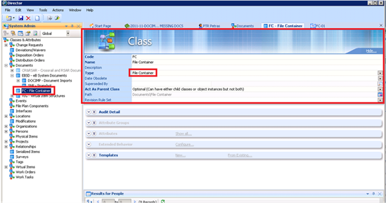

1) Create Document Class with Type set as “File Container”

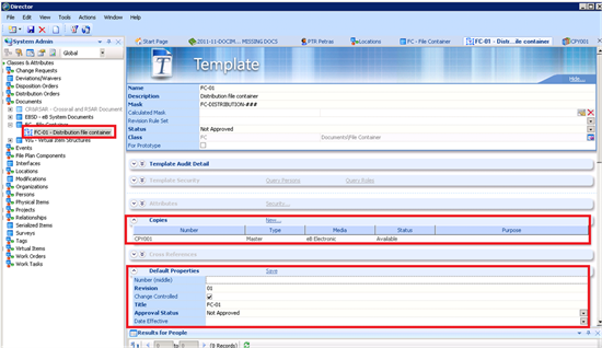

2) Create Template for this Document type, fill all mandatory fields and create a Copy for this template as shown in a screenshot below. After filling all the details Approve the Template.

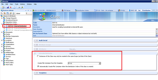

3)Select Item Class you would like file upload functionality  to be used for and under “Extended Behavior” topic, from drop down menu, select previously created File Container and tick option “Automatically Create File Container when the Item of this Class is created".
After taking these steps, you should be able uploading files to specified Class.
Note. This File Container can be used for other eB Item Classes.
