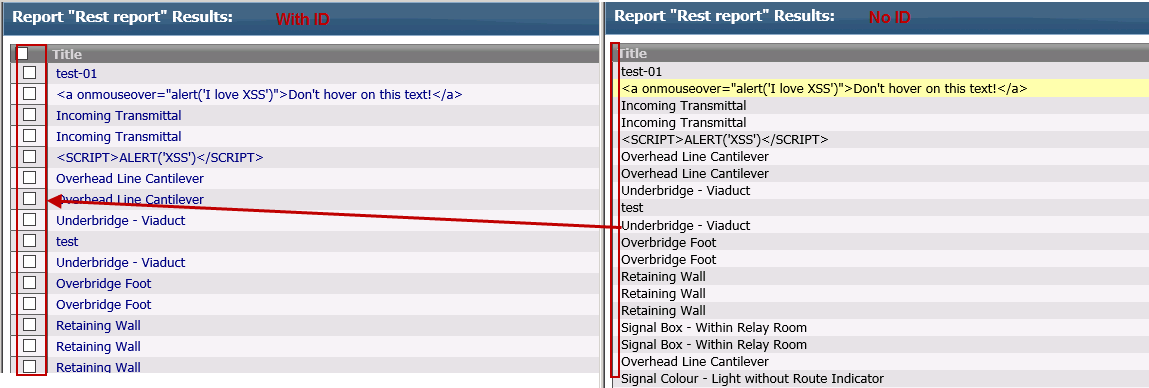

In this eB wiki we will explain how to enable check boxes for interactive reports in eb WEB.

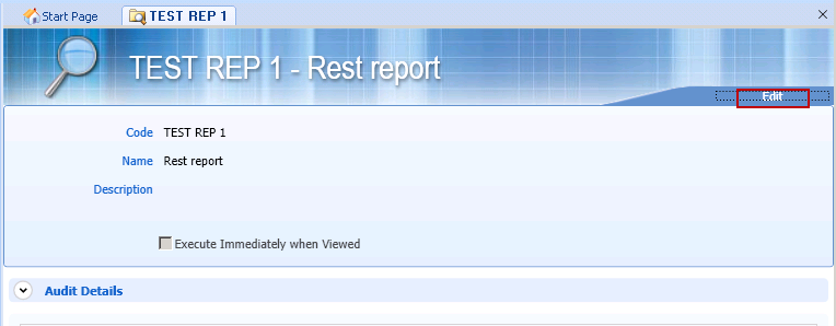

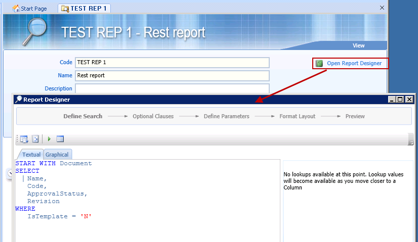

  1. In Director open Interactive report in edit mode and open Report Builder.

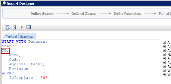

  2. Under Select statement add 'Id' field

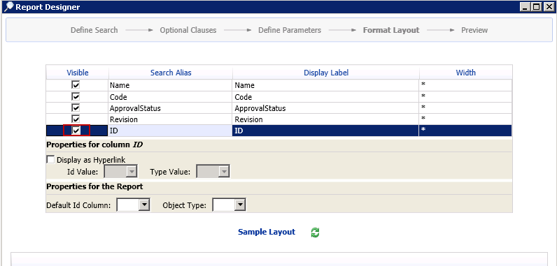

  3. As this property is not required by user you can hide it under 'Format Layout' tab by unchecking 'Visible' box
