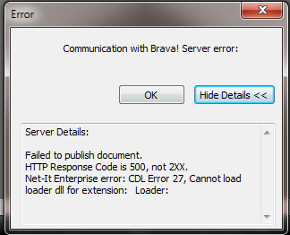

Error message received when trying to view dwg file in Brava viewer.
Communication with Brava! Server error:
Server Details:
Failed to publish document.
HTTP Response Code is 500, not 2xx
Net-It Enterprise error: CDL Error 27, Cannot load loader dll for extension: Loader:

First, download and install Autodesk DWG TrueView 2014. You can download this at the below link.
http://usa.autodesk.com/adsk/servlet/pc/item?id=9078813&siteID=123112
After installing the software, follow the below instructions.
1. Navigate to the C:\Program Files (x86)\Autodesk\DWG TrueView\Fonts directory.
2. Copy and paste all SHX files into the DWG_Fonts folder for Brava.
a. Brava Desktop: C:\Program Files (x86)\IGC\Brava! Desktop\DWG_Fonts
b. Brava Enterprise: C:\Program Files (x86)\IGC\Brava!\Brava! Enterprise JobProcessor\DWG_Fonts
c. Brava Enterprise .NET: C:\Program Files (x86)\IGC\Brava! Enterprise .NET\JobProcessor\DWG_Fonts
3. Navigate to ftp://ftp2.infograph.com/DL/Miscellaneous/Drivers/DWG2DL.zip.
4. Copy the contents of the directory into the same Brava folder (not fonts).
5. Overwrite the currently existing files.
If Brava Enterprise is being used, restart Apache or Brava! Server service and delete the contents of the cache (displaylistcache for BESS, dlcache for BEN).
