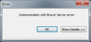

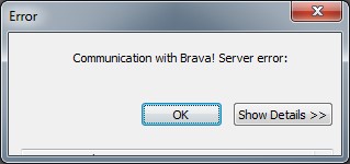

There is an ERROR MESSAGE IN BRAVA WHEN TRYING TO OPEN A FILE - Failed to publish document. HTTP Response Code is 500, not 2XX.
Net-It Enterprise error: Critical CDL Error:  (0x800A):
'The invocation of the constructor on type 'System.Windows.Documents.DocumentReference' that matches the specified binding constraints threw an exception.'
Line number '2' and line position '21' COMMUNICATION WITH BRAVA FAILED.
Root Cause:
Due to a stamp that was added to the file externally, it does not allow Brava to read the file.
Takeout the file from the system and  stamp needed to be flattened in order for Brava to open the file.
