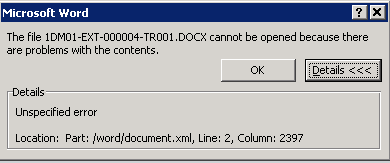

Merged document fails to open with error message: The file xxx.docx cannot be opened because there are problems with the contents. Details: Unspecified error.
Reason
This error is received when Content Controls object is created in table.

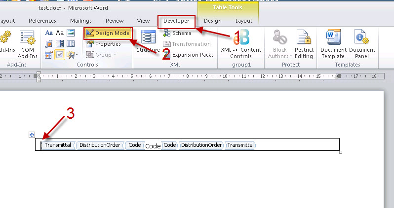

Steps to Resolve
- Open Template file used for this merge.
- In word navigate to Developer tab
- Enable Design Mode
- Click On Content Control object, cursor will appear on Content Control objects text field.
- Using cursor movement keys (arrow keys on keyboard) navigate cursor just in front of Content Control object.
- Add space symbol (all table columns containing CC object should have a space symbol in front of CC object )
