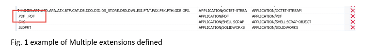

Finding:
In the case when multiple extensions are configurated for the PDF application, the first extension configured is taken and register as the target_file. unfortunately, the Interplot Rendition Engine is unable to process this and crashes the queue.
To resolve this is, reorder the extension and make the .PDF be the first extension for the Interplot Rendition Engine used in eB AssetWise.
