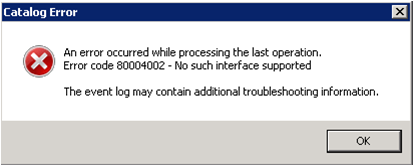

Problem Description
eB system becomes unresponsive and throws an error when you try to login or use the system and when trying to restart COM+ component Error Messages received: (Error code 80004002 - No such interface supported)
 The only way to restart COM+component is to restart whole application server.
