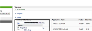

Check In – Check out and other options not visible under File > Action Section. Only the Properties option is available.

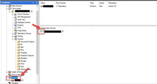

Workaround: There might be a possibility that the file got uploaded but got stuck in the storage queue with ready status. In order to resolve the issue, follow the below steps
If still, the jobs doesn't process, then follow the below steps
Which should process all the jobs and you must be able to see the Check-In/Check out and all other options on the Web.
