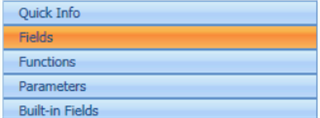

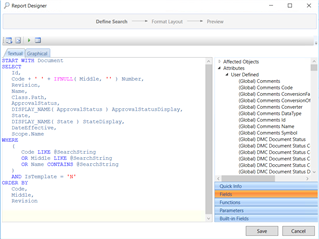

5) Select “Open Report Designer” on the right Select the “Fields” option. This will allow the user to select additional criteria that can be added on the search
6) In Open Designer Window you can put additional search criteria from Field. For eg. Attribute
Type in a comma after every additional field that is added

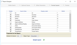

7) Once the user is complete with the “Define Search” window select the link for the “Format Layout” window and change the selections to what should be visible and displayed in the search results.
8) Note: You can select and drag and drop fields in your search criteria to change the display order.
Once the user is complete select the “Save” button which will return the user to the Core quick search screen. Add the newly created search by selecting the “Save” icon on the toolbar.

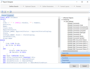

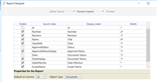

6) Select “Open Report Designer” on the right Select the “Fields” option. This will allow the user to select additional criteria that can be added on the search.
 For eg. Attribute
