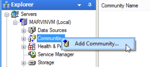

To add a Community
3.Right-click the Communities node and select Add Community.

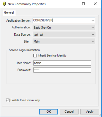

The New Community Properties dialog opens.
5. From the Authentication list, select either Basic Sign-on or Basic Sign-On (Over Web).
This information should be in your AssetWise Installation Worksheet (Datasource name).
Click OK
