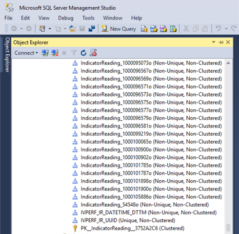

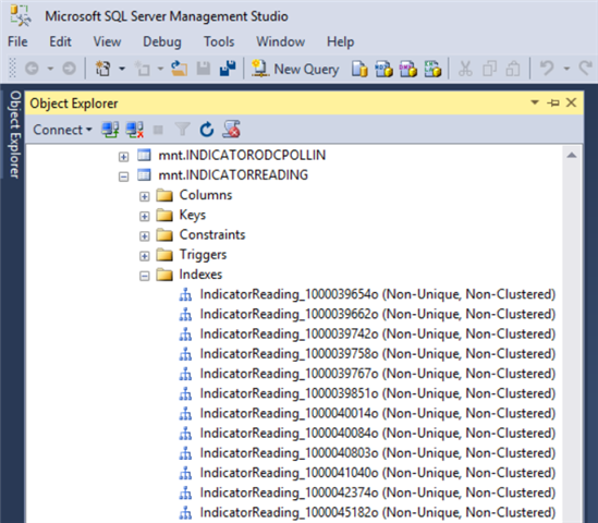

2. If there are no error messages in the error logs that appear suspicious and the problem isn't replicated in the clean environment, have the  user's DBA check the database indexes. APM support can suggest the data tables to review, such as mnt.IndicatorReadings, etc. The DBA can then run the checkindex scripts from APM. If these scripts find nothing wrong, then the DBA can manually compare the Indexes for the questionable data tables, such as mnt.IndicatorReading in the user's problematic environment's database with the indexes for the same data table in the clean environment's database. The indexes in question are usually those titled IVPERF, found at the end of the list of indexes for the data table.
Example 1. Indexes in the mnt.INDICATORREADING table in the problematic database

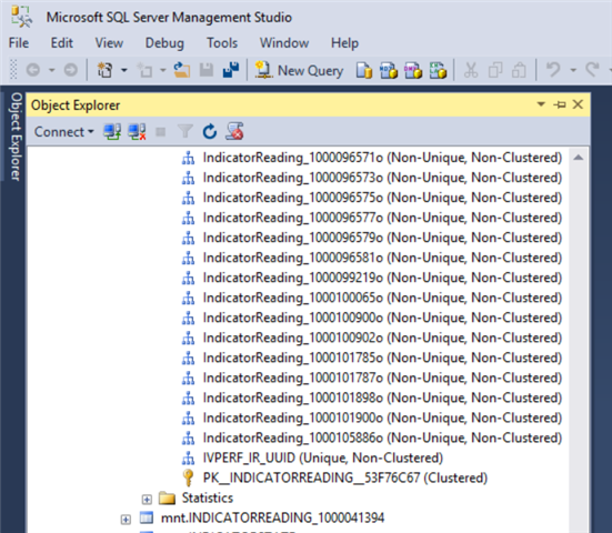

Example 2.  Indexes in the mnt.INDICATORREADING table in the clean database.

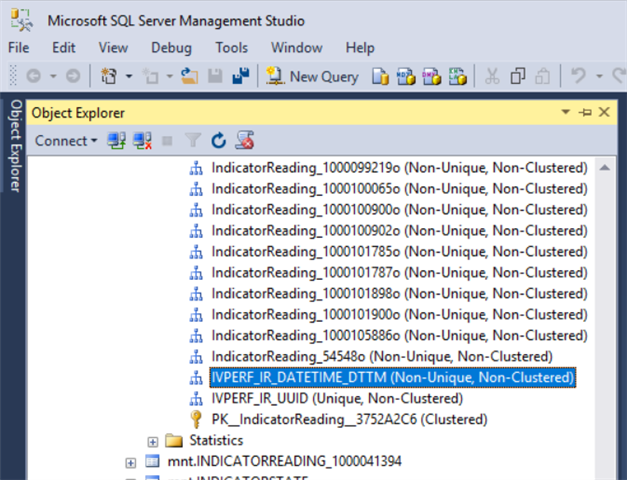

Note, in the example, the index called IVPERF_IR_DATETIME_DTTM is only found in the problematic environment, indicating that this is a custom index:
In this case, ask the user's DBA to try disabling the custom index in the problematic environment's database:
Once disabled, try to access the problematic view to see if the slow load or hang has been resolved.
If this does indeed resolve the reported issue, the user's DBA or the Bentley Technical Consultant should be contacted to determine the need for the custom index. If the custom index is not required, then the index should remain disabled and disabled in any other environments. If the Index is required, then the Bentley Consultant and DBA will need to correct the issue with the custom index. It may simply need to be rebuilt, corrected or put on a regular maintenance schedule.
