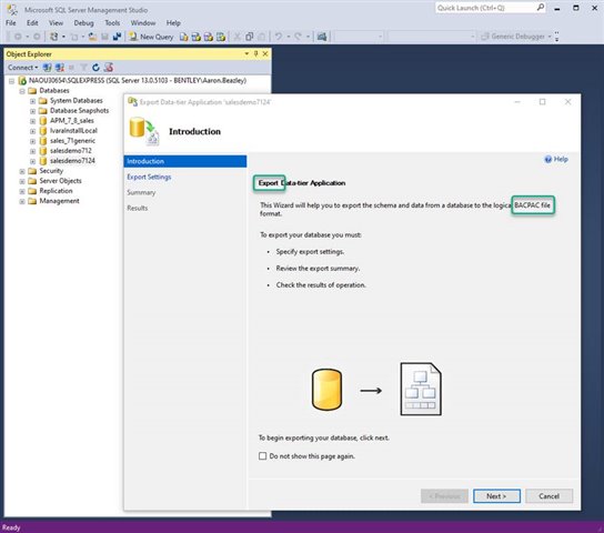

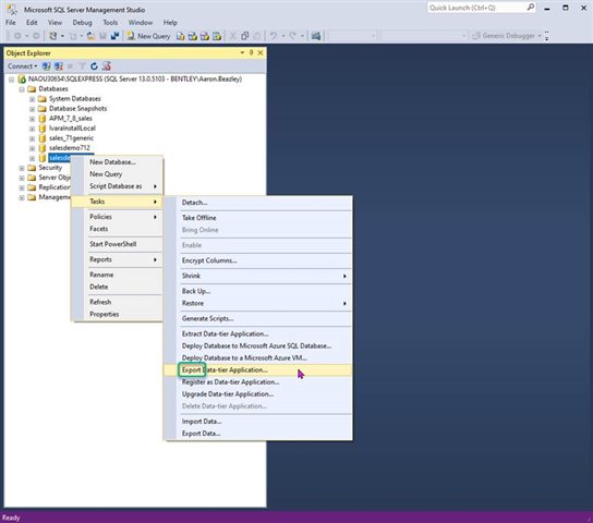

To start the process go to Tasks menu in SQL Server Management Studio
Follow prompts:

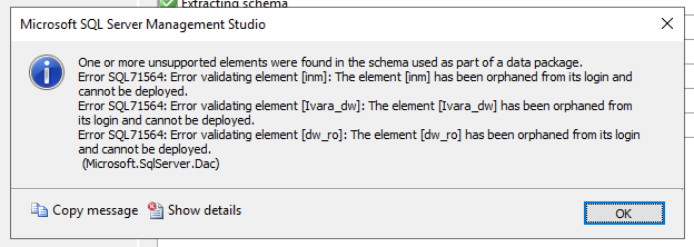

Sample errors:
 Typically, there is helpful information to remove the things that are causing problems.
One or more unsupported elements were found in the schema used as part of a data package.
Error SQL71564: Error validating element [inm]: The element [inm] has been orphaned from its login and cannot be deployed.
Error SQL71564: Error validating element [Ivara_dw]: The element [Ivara_dw] has been orphaned from its login and cannot be deployed.
Error SQL71564: Error validating element [dw_ro]: The element [dw_ro] has been orphaned from its login and cannot be deployed.
 (Microsoft.SqlServer.Dac)
The solution in this scenario was to manually delete the two orphaned database users from the security folder that belongs to the database, so happened that their associated SQL Server logins no longer exist on the instance.
