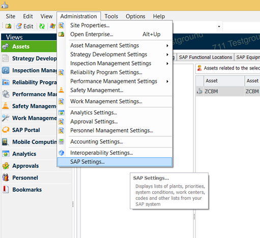

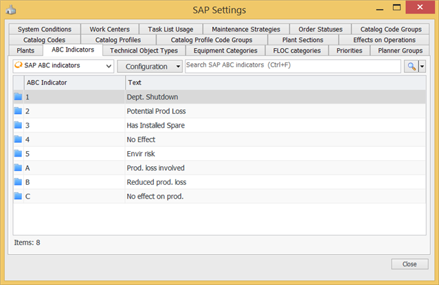

SAP ABC Criticality (ABC Indicator) is found here:

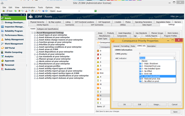

APM Consequence Priority and mappings are found here:
For those Consequence Priorities that are mapped to ABC Criticalities that do not exist in the SAP System, you will need to find the Assets in APM and update the APM Assets' Consequence Priority to "none".

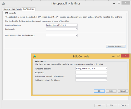

After all changes are made, you will need to update the Interoperability Settings and change the date SAP Control for the SAP Extract Date. This should be set to the date of the SAP back-up used to restore the SAP Test environment.

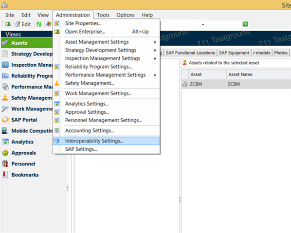

SAP Interoperability Control settings are found here:
