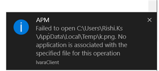

.png files attached in APM not opening up when PAINT Application is Set as Default Application in Windows/ OS.
On trying to open up the .png file Gives the Following Error.
APM supports PAINT 3D and PHOTOS application for viewing the .png files attached/ embedded in the Software.
To view the .png files the default Application to view .png in the Windows has to be set as PAINT 3D or PHOTOS.
For Ensuring this in Windows 10 Go to :-
Settings in Windows > Default Apps > Choose Default apps by file type >  for .png file set PHOTOS/ PAINT 3D.
