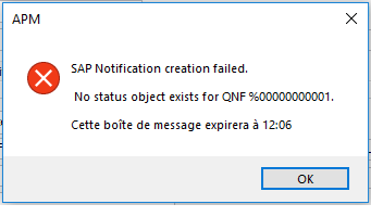

In an SAP Gateway integrated environment, user is unable to complete an Alarm Acknowledgement with a Notification. User populated all necessary attributes and selected notification types, M1, M2 or M3 Notification Tasks. An error dialogue launches with the following message, "SAP Notification creation failed. No status object exists for QNF %00000000001":
The user is able to complete an acknowledgement with an SAP Maintenance Order but not an SAP Notification.
The error message dialogue receives the "No status object exists for QNF %00000000001" message directly from an SAP response. This message indicates that the set-up of SAP is what is rejecting the Notification request through the ZAPMExternalData service.
Upon investigation with the user's SAP Functional Consultant, it was found that a sub-class of objects in SAP, the Notification Task object was not set-up, views were not enabled, etc for this Notification Task object, despite the Notification being completely set-up. When the APM SAP Gateway sends a Notification request to SAP, it sends all of the required SAP Notification attributes with it but also includes a component to create a Notification Task to SAP.
