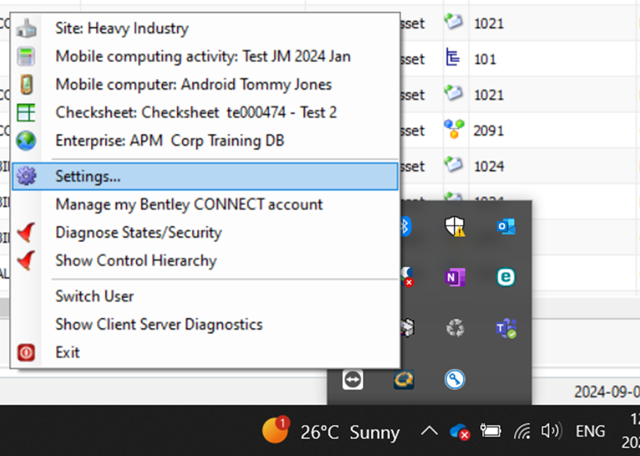

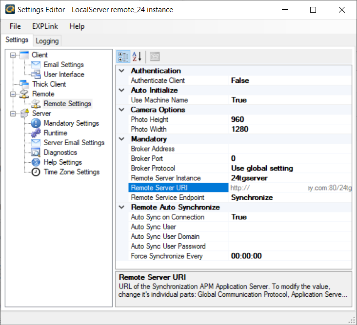

12. Some users can synchronize without issue but 1 user cannot and receives the following type of error:
"synchronization Failure EXCEPTION OCCURRED:EndpointNotFoundException There was no endpoint listening at https://apm-proddomain.com/default/RemoteService/Synchronize/ that could accept the message. This is often caused by an incorrect address or SOAP action."
    1.  Check that "Username" has appropriate Windows Security to Read, Write & Modify the folder
      1. C:\ProgramData\Bentley\IvaraEXP\
    2. Launch the Remote Client form the erroring computer, right click on the Bentley APM icon in the task tray and choose settings from the  list of option:
This will launch the APM configuration tool, compare the Remote settings for the working and non-working remote clients, it is most likely that the Remote Server URI is different between the instances, update the non-working remote with the new URI or fully uninstall APM Remote From the non-working computer and redownload from the remote deployment share:
