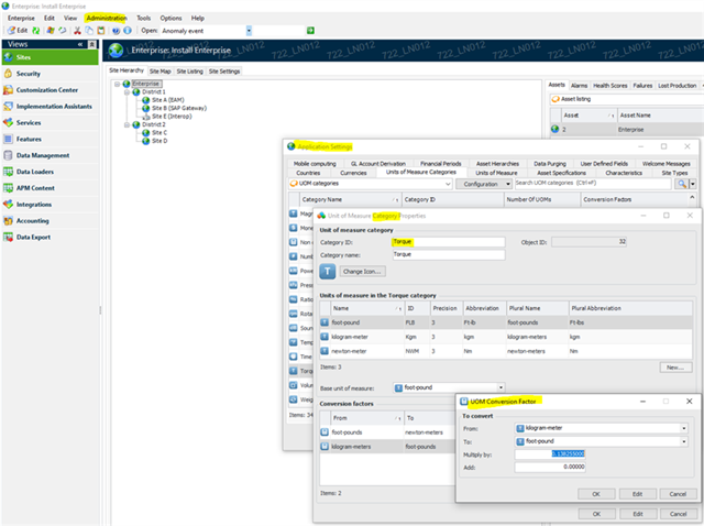

To update UOMs
Go to Enterprise > Administration > Application Settings > Units of Measure Categories

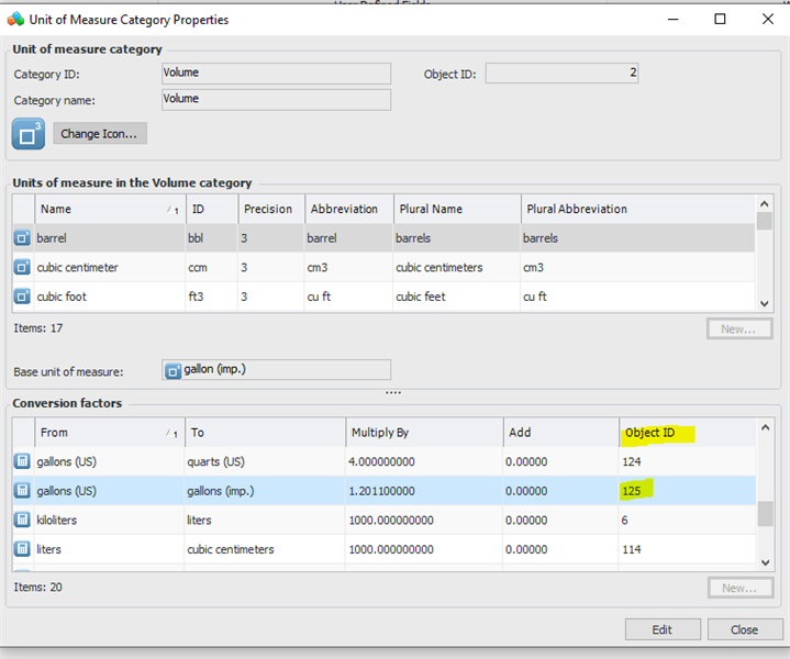

NOTE: If you add the OID to the Conversion Factors config, you can be sure that you are editing the correct conversion factor:
Repeat to correct all in list above.
