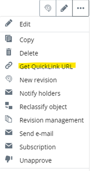

1. Open the ALIM document you wish to use in the mobile application.
2. Get a quick link to it.

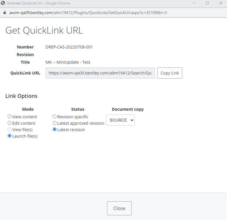

3. Set the mode to Launch file(s) and select the revision you want. Then click Copy Link.

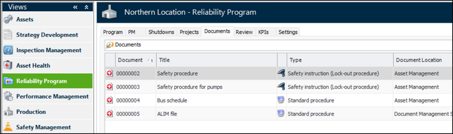

6. Go to the site where you wish to add the document.
7. Select the Reliability Program view:
8. Select the Documents tab.

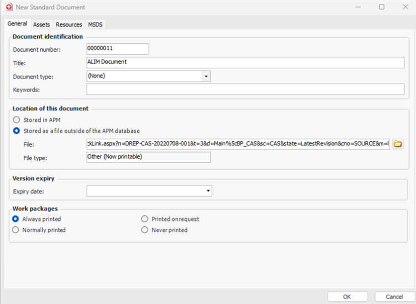

9. Click New in the lower right corner.
10. Title the document and select "Stored as a file outside of the APM database".
11. Paste the link into the File box.
12. Click OK. The file is saved and listed in the Documents tab.

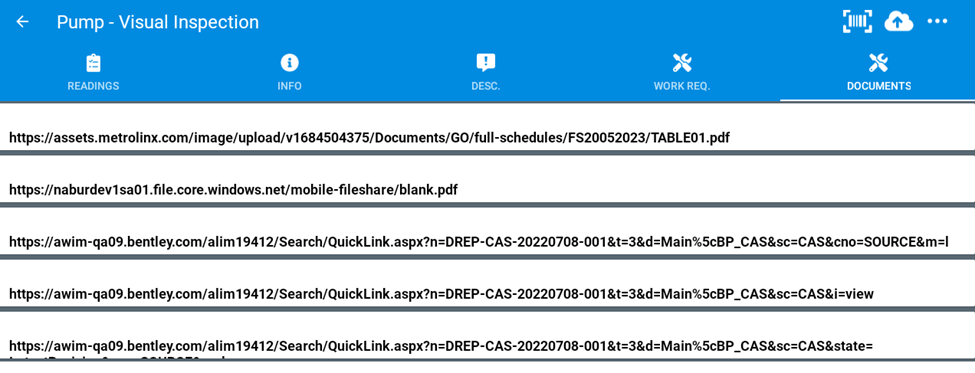

18. Open a checksheet on mobile and view the Documents list. For example.
Currently, only links are shown. Document titles are coming soon.

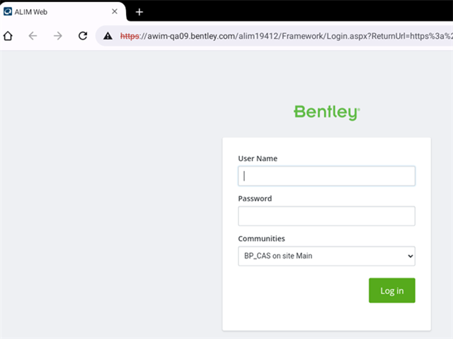

19. Click the relevant document. The ALIM Log In appears:
20. Log in.

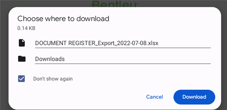

21. Download the file:
22. Open the file in your preferred editor. Make edits and take screenshots as required.

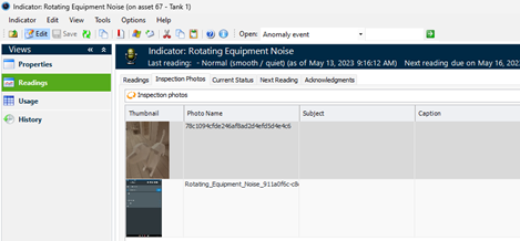

23. On the relevant indicator reading, you can add the screenshots from the gallery.
24. When you upload to APM, you can view the photo on the indicator. For example:
