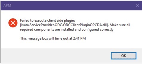

When browsing for ODC tags on from the server, either using a thick client or a smart client, the browse results in the following error:
"Filed to execute client side plugin: [Ivara.ServiceProvider.ODC.ODCClientPluginPIDA.dll]…"

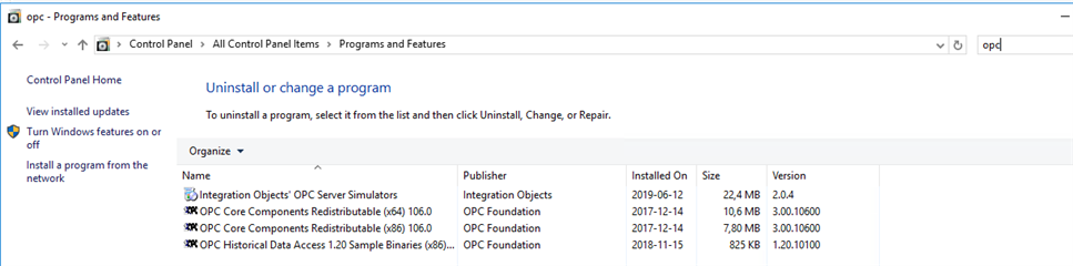

After checking that the ODC Plugins were not blocked the user then checked that the OPC Core Components were installed on the Server and the end-user's laptop. The OPC Core Components were installed on the server but not on the End-user's computer.
In order for a smart-client to be able to browse for tags you need the OPC core components to be installed locally on the client machine not just on the server machine.To check if the OPC Core Components are installed run Windows>Control Panel\Programs\Programs and Features on the server and on the end-user's computer.

Both the 32-bit and 64-bit core components are in there and must be installed for the tag browse to be successful from that machine.
