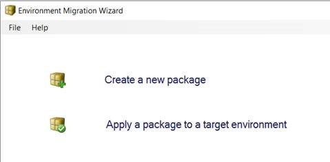

The Environment Migration Wizard supports two processes and guides you through the steps. The first is to create a package file. This file may include multiple different kinds of data. I am going to take you through the simple case of transferring Customizations (modelling data including configurations).

| 2. | On the Development server run the Environment Migration Wizard. |
| 3. | Choose the option to “Create a new package” |

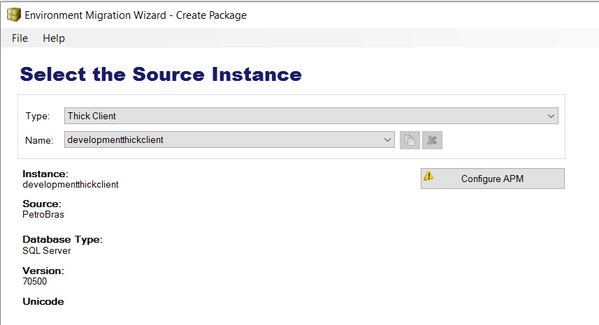

| 5. | Now select an instance that you wish to use as the Source for the package. In your case, you will choose a Development instance. Click Next. |

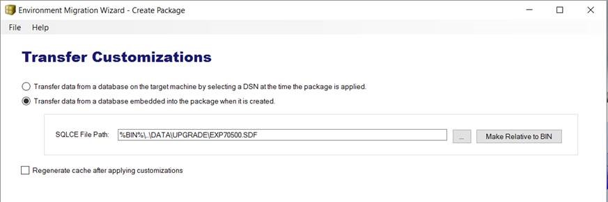

| 6. | Now you may choose what transports you want to include in the package. We are simply going to pick Transfer Customizations and then click “Add >>”. This transport only affects the database so we only need to apply it once when we apply it to Production. Other transports include files that affect the software installation and in those cases we would need to apply the package to both the application and the integration servers in Production. Click Next. |
| 7. | On the next screen I always leave the defaults and simply click Next. |

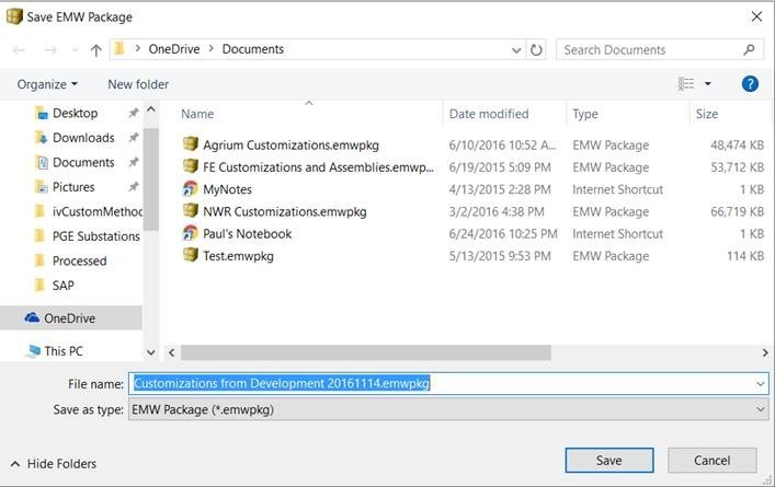

| 9. | You will be asked where to save the package. I would suggest creating a folder for the packages (and the projects) so you always know where to go to find them. I usually would add the date into the file name. Click Save |

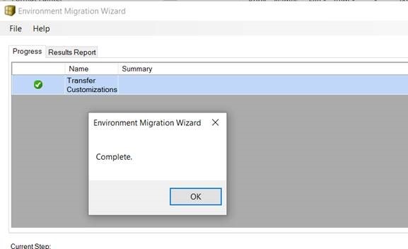

| 10. | Saving the package will complete in a minute or two and you will be informed when it is complete. Click OK, and then click Close. |

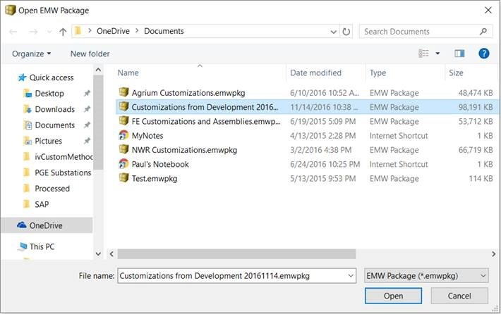

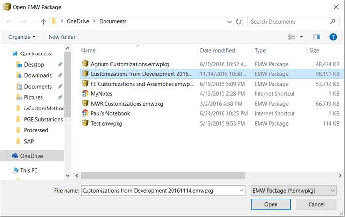

| 5. | Choose the file you created in Development and click Open. |

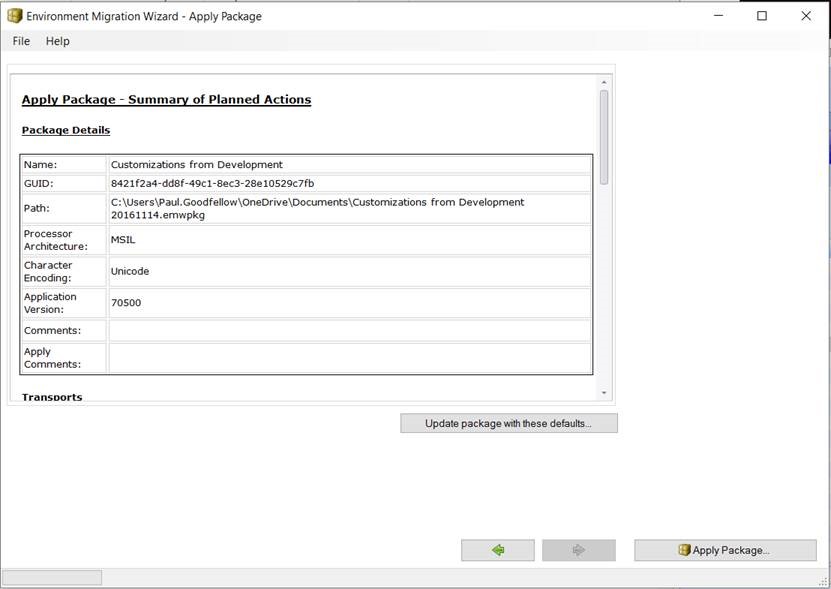

| 6. | You will be presented with information the Wizard finds in the file. You should review the information to make sure it is what you expect. Click Next. |

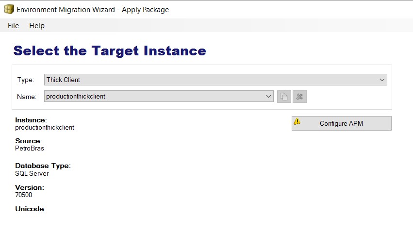

| 7. | Now you must choose the Target instance you want to apply this package to. You may choose any of the Production instances. Click Next. |

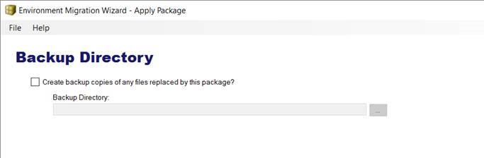

| 8. | As our example only affects the database then the next step does not apply. You will be asked if you want to create a backup directory. This is for the case where your package includes files that affect the software installation. Click Next. |

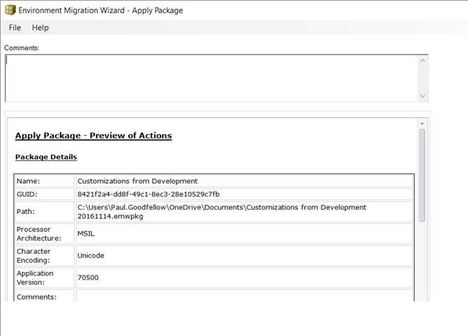

| 9. | Now you will be presented with information of what the Wizard is about to do. Please review and then click “Apply Package”. |
| 10. | Once this is complete I would launch a Thick Client to make sure the process runs, and then restart all the APM services. |
