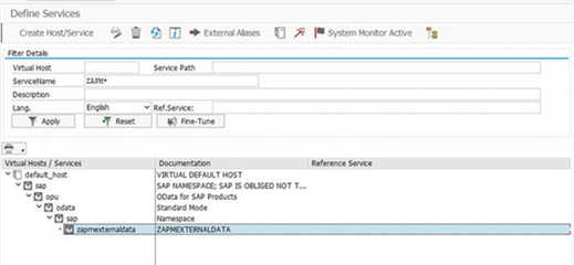

1.Find the zapmexternaldata service in SAP.
Note - This is the service that was set-up in Chapter 2 of the APM Interoperability Guide for SAP Plant Maintenance, page 11. For reference, this guide is found in the APM install folder using the following path by default;
C:\Program Files\Bentley\AssetWise Performance Management\Docs\English\Technical_Guides.

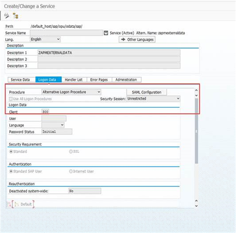

2. Update the ZAPMExternalData Service via “Change a Service”.
3. Change the Procedure to “Basic Authentication”.

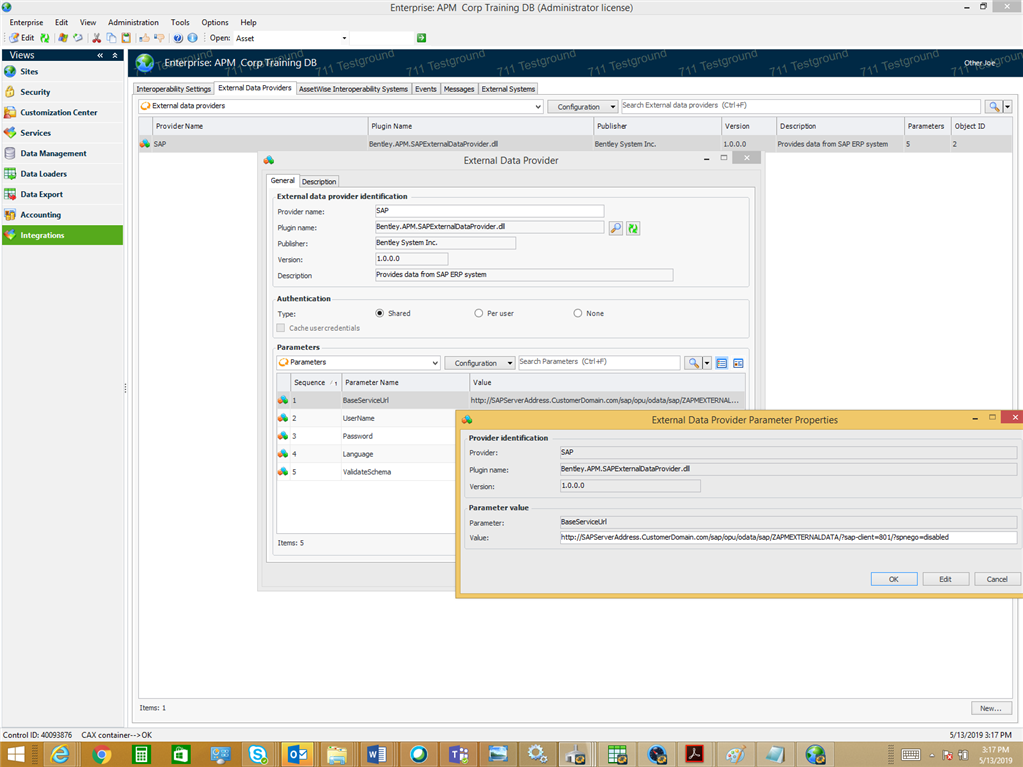

Once the above the ZAAPM External Data Service is set-up to use Basic Authentication, you may still get an error when trying to send the notification of ABC Indicator update. In this case, you will need to update the  SAP External Data Provider in APM with a parameter to bypass secondary authentication. To do this, simply add the phrase "?spnego=disabled" at the end of the SAP External Data Provider URL in APM.
For example, the url changes to something like:
http://SAPServerAddress.CustomerDomain.com/sap/opu/odata/sap/ZAPMEXTERNALDATA/?sap-client=801/?spnego=disabled
