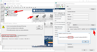

Trying to setup OPCDA access, and get following errors in APM and Matrikon:
Sample Log file error in APM:
2018-12-09 19:46:42.0558Z Error SERVER$ Ivara.ServiceProvider.ODC.CreationRuleBatchProcessor [53] Failed to read indicator: Indicator [ODC-BUFFER FLUID REFILL PUMP PU493,XM497 WORKING HOUR] from plugin [prododc::opcda://localhost/AIM.OPC.1/ad853bf1-1e22-11d5-9038-0050da19ddda] EXCEPTION OCCURRED:NullReferenceException Object reference not set to an instance of an object.    at OPCDA.NET.SyncIOGroup.Add(String , Int32& , Boolean ›, VarEnum „)
   at OPCDA.NET.SyncIOGroup.Add(String , Int32& )
   at OPCDA.NET.SyncIOGroup.Add(String name)
   at Ivara.ServiceProvider.ODC.OPCDAPlugin.OpcDaAgent.<GetValues>d__8.MoveNext()
   at System.Collections.Generic.List`1..ctor(IEnumerable`1 collection)
   at System.Linq.Enumerable.ToList[TSource](IEnumerable`1 source)
   at Ivara.ServiceProvider.ODC.Common.ODCPluginBase.PollIndicator_Impl(EXPLinkSession session, Indicator indicator, ODCReadingCreationRule pollingRule, ODCReadingRequest readingRequest) in F:\SRC\hotfixes\7.10.0.209\APM\Service Providers\ODC\IvaraODCCommon\ODCPluginBase.cs:line 795
   at Ivara.ServiceProvider.ODC.Common.ODCPluginBase.PollIndicator(EXPLinkSession session, Indicator indicator, ODCReadingCreationRule pollingRule) in F:\SRC\hotfixes\7.10.0.209\APM\Service Providers\ODC\IvaraODCCommon\ODCPluginBase.cs:line 477
   at Ivara.ServiceProvider.ODC.CreationRuleBatchProcessor.ProcessBatchThread() in F:\SRC\hotfixes\7.10.0.209\APM\Service Providers\ODC\IvaraODCServiceProvider\CreationRuleBatchProcessor.cs:line 226
The communication was restored and the client connects without error after the following 2 changes on the OPC Server side:
1. Authentication was changed from Identify to Anonymous
2. The OPC Server was rebooted
