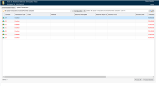

Users may face some issues while using APM Mobile Inspection application, for example;
     1. iOS/Android application shows that all the readings are uploaded to server, but iOS/Android Device >> Synchronization view >> Upload Transactions tab on client shows empty transactions.

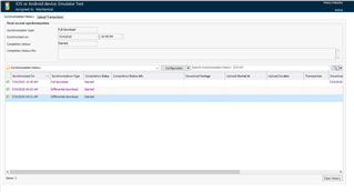

     2. Whenever the data is downloaded or uploaded to/from Mobile Inspection application, iOS/Android Device >> Synchronization view >> Synchronization History tab shows synchronization type Differential Download, Full Download, Upload with completion status as Started.

In order to troubleshoot these issues, first confirm if the User who is performing download and upload activities on Mobile Inspection application has a security profile assigned to him/her.
If yes, make sure the four classes mentioned below are editable in the corresponding security profile;
  1. Synchronization history
  2. Mobile computing audit info
  3. Mobile computing activity
  4. Upload transaction
If the problem persists even after making these classes editable in the security profile, please submit a service request.
