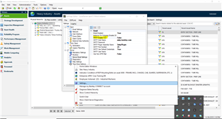

To fix the above error, go to Settings Editor of the instance configured for sending email notification post alarm acknowledgement. Go to Advanced Settings under File menu.
Now in Server Email Settings, set "SMTP Enable TLS" option to False.
