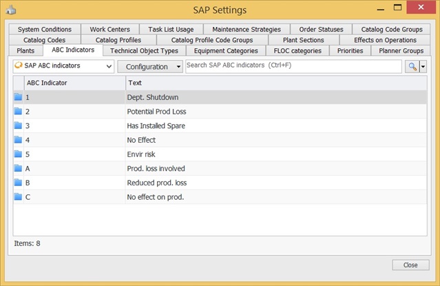

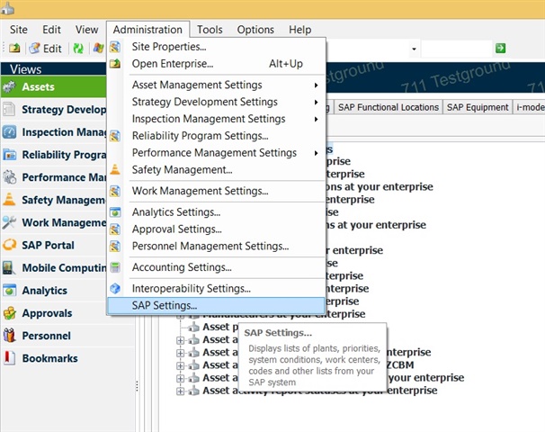

2. Check the SAP ABC Indicators for the Site and make note of the values. Open the Site's Administration pulldown menu and select "SAP Settings" and go to the "ABC Indicators" tab:

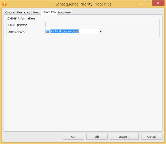

3. Check the Consequence Priority mappings for the Site. Open the Site to the Assets view > Settings tab > Consequence Priorities sub-tab, open each Consequence Priority one at a time to the CMMS Info tab. Check that the ABC Indicator is properly selected. Repeat for all Consequence Priorities and make sure no SAP Indicators are not mapped.

5. In APM, return to the Site to the Assets view > Settings tab > Consequence Priorities sub-tab, open each Consequence Priority one at a time to the CMMS Info tab. For any that have a blank ABC Indicator, change the ABC Indicator to a value, select one, click OK to commit the change, then reopen it and select "(None)", click OK to commit the change. Repeat for all unmapped Consequence Priorities.
