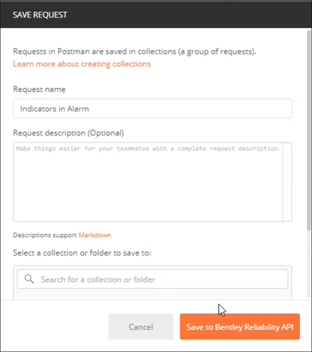

1. In the collection you created previously (for example, “Bentley Reliability API”), create a request. Right-click the collection name and click Add Request.
The Save Request dialog opens.
2. For the Request name, enter “Indicators in Alarm”.
3. Click Save. “Indicators in Alarm” is added to the requests in the collection.

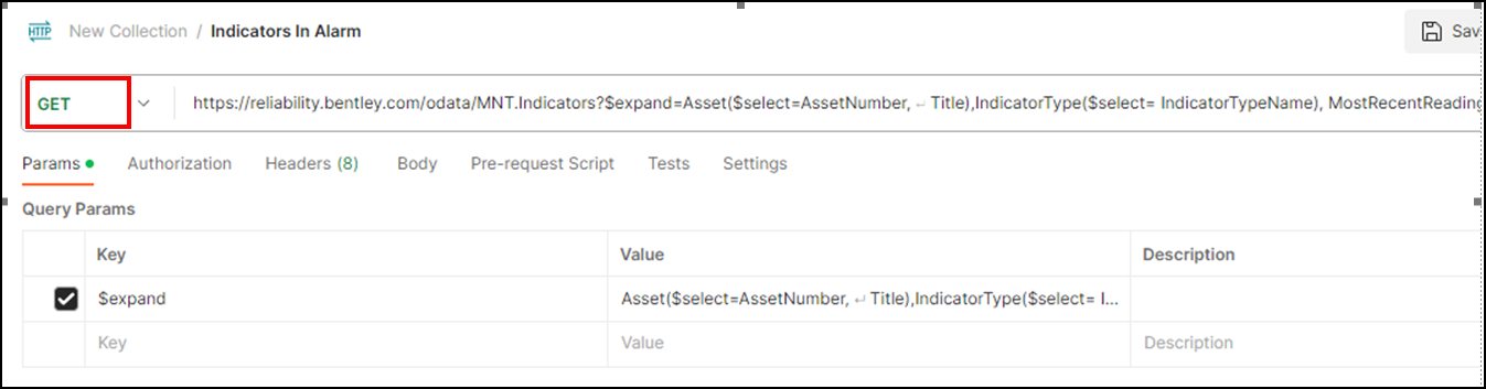

4. Select the request and enter the request URL in the GET line:
https://reliability.bentley.com/odata/MNT.Indicators?$expand=Asset($select=AssetNumber,
Title),IndicatorType($select= IndicatorTypeName), MostRecentReading($select=CombinedValueCollected,DateTimeCollected; $expand=AlarmType($select=AlarmTypeName),CollectedBy($select=EmployeeName))

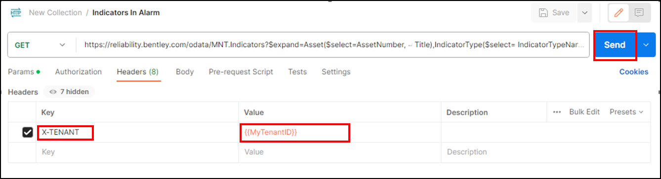

6. Select the Headers tab and add the Key (Tenant) and Value (GUID) that Bentley assigned to your database.
7. Click Send. The Body section displays the result. For example:

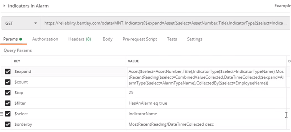

Not all parameters need to be included in the GET line. They can be set in the Params tab only, as shown here when the Query Params section is expanded:
Indicators?$expand=Asset($select=AssetNumber,Title), IndicatorType($select= IndicatorTypeName)

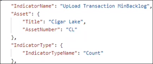

The indicator name and information about the indicator’s asset are returned (AssetNumber and Title), as well as the indicator type. For example:

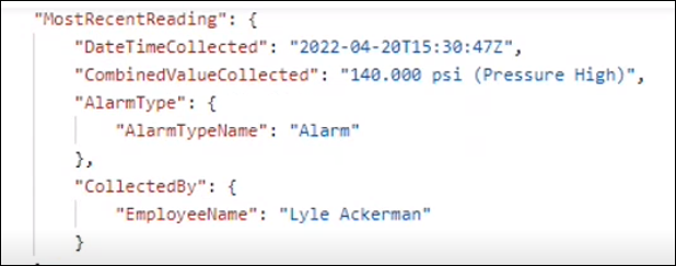

MostRecentReading($select=CombinedValueCollected,DateTimeCollected;$expand=AlarmType ($select=AlarmTypeName),CollectedBy($select=EmployeeName))
For the most recent reading, the combined value collected and date and time collected are returned, as well as the alarm type and “collected by” values for the most recent reading:
$filter – HasAnAlarm eq true
Only indicator readings with unacknowledged alarms are returned.
$orderby – MostRecentReading/DateTimeCollected desc
Readings are organized according to the date and time they were collected.
