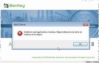

Trying to log into APM using a thick Client, getting the following error on screen
Unable to read application modules.  Object reference not set to an instance of an object
or
Unable to perform a direct read on the oUser record to obtain user privileges.  User privileges will default to End User.  Exception has been thrown by the target of an invocation.

This Error was found to be caused by using a no longer supported version of Oracle client.
As of 7.8, Oracle client 11g is no longer supported.
