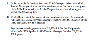

If the below error pops up while deploying Smart Client via the APM Server Manager:
Granting permission to the Web Site to "IIS AppPool\APMServerManager" as per below in the documentation resolved the issue:
Followed by granting permission for the folder App_Data for IIS_IUSRS:
NOTE :  A similar issue was observed in MaS upgrades. At the time, the work around was to click "No" to the deployment question and copying the files manually.
