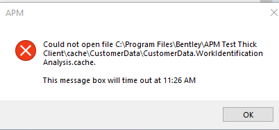

When trying to save customizations, such making changes to a custom report or UI changes, user experiences an error where they cannot write to a file in the cache folder (Customer Data). The error message appears similar to the following:
The error indicates that the user is running with cache in the thick client that they are using and they are either not permitted to modify the contents of the cache folder or that files are missing in the cache folder. Unless you are experienced to generating cache and understand Bentley APM architecture and running with cache, we suggest to first check with Bentley APM Support via an SR or contacting your Bentley APM Consultant before changing your approach.

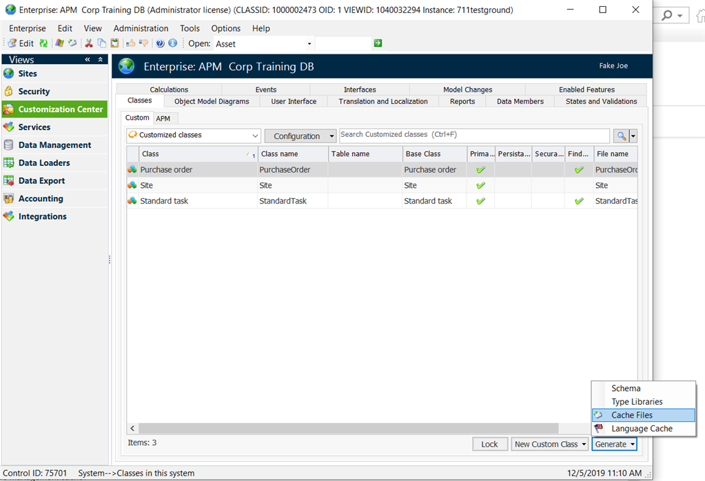

Next, stop all services and thick-clients. On the Application server launch a thick-client with the Admin key. Go to the Enterprise level > Customization Center view > Classes tab > Custom subtab. Click on the Generate button in the lower right corner of the screen and select Cache. This may take several minutes to complete.
Restart the Application Server and test via a smart client.
