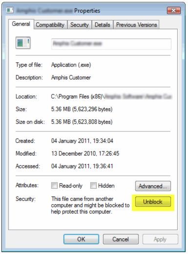

One or more files (e.g., .dll, .exe) cannot be loaded during startup of a server instance.
A server log message, similar to the following, is posted, and may be seen in the Web Monitor.
"Exception occurred loading WCF Plugin: Ivara.Replication.Remote.RemoteService.RemoteServicePlugin, RemoteService, Version=7.4.0.0, Culture=neutral, PublicKeyToken=null.  See log file for exception details...."
The issue happens when a file (e.g., a DLL or EXE) is manually copied into the server binaries folder from a zip downloaded from the Internet (e.g., hotfixes or custom DLLs). This is controled by a server setting that flags the file when it is downloaded. (more info: http://www.howtogeek.com/70012/what-causes-the-file-downloaded-from-the-internet-warning-and-how-can-i-easily-remove-it/)
As far as we know, it doesn’t happen to files which are created via an installer.
This seeting prevents the process from accessing the file; the symptoms could vary.
To resolve, find the blocked file and go to the properties of the file and unblock it. Mass update is possible too (see link above)
