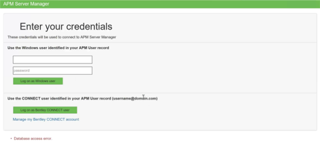

An APM user with Oracle database environment would receive a "Database access error" when attempting to logon to the APM Server Manager or when trying to deploy an APM Smart Client package via the Server Manager:

It was found that the user had recently updated the Oracle database from Oracle release 12 to Oracle release 19. Keeping both Oracle client instances and associated drivers installed on the server. There results in a conflict whereby the server tries to connect the Server Manager to the Oracle 12 client for database authentication using the Oracle 19 drivers to the Oracle 19 database.
Bentley recommends that the user only use one Oracle Client instance on the server and that all versions of the Oracle client, Oracle drivers and Oracle database match, otherwise this conflict may cause various APM services to fail or work with unexpected results.
A bypass has been developed which adds a section of code to the Web.Config file that forces the Server Manager website to use the Oracle 19 client.
Please launch an SR if you believe that you are experiencing this issue and wish to use the workaround.
