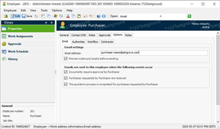

Below are the mentioned roles which needs to be assigned to the respective individuals of a site for getting email notifications for purchase requisitions or for reserving a resource to be purchased:
1. Purchaser/Buyer -  Preview - On, Documents – On, Purchases – On, Quotation – On
2. Manager - Preview - On, Documents – On, Purchases – Off, Quotation – Off
3. Maintenance/Operations end-user - Preview – Off, Document – Off, Purchases – Off, Quotation – Off
4. Service User - Preview – Off, Document – Off, Purchases – Off, Quotation – Off
NOTE : Service user also needs to have a value email account, verified with the Email Admins. Also, Outlook needs to be fully installed on the Servers performing services, including the app server, and the Service User’s email account(s) need to be defined on those servers. Service user’s Personnel profile needs to be linked with the Service’s Username in APM.
