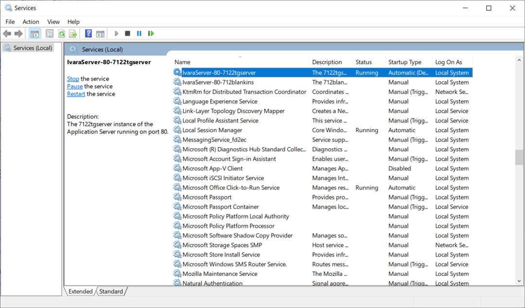

1. Open Windows Services and find the exact name(s) of the APM or “Ivara” Service(s) you wish to stop:
In this example it is “IvaraServer-80-7122tgserver” but your environment these will be named differently and most likely have more services running.

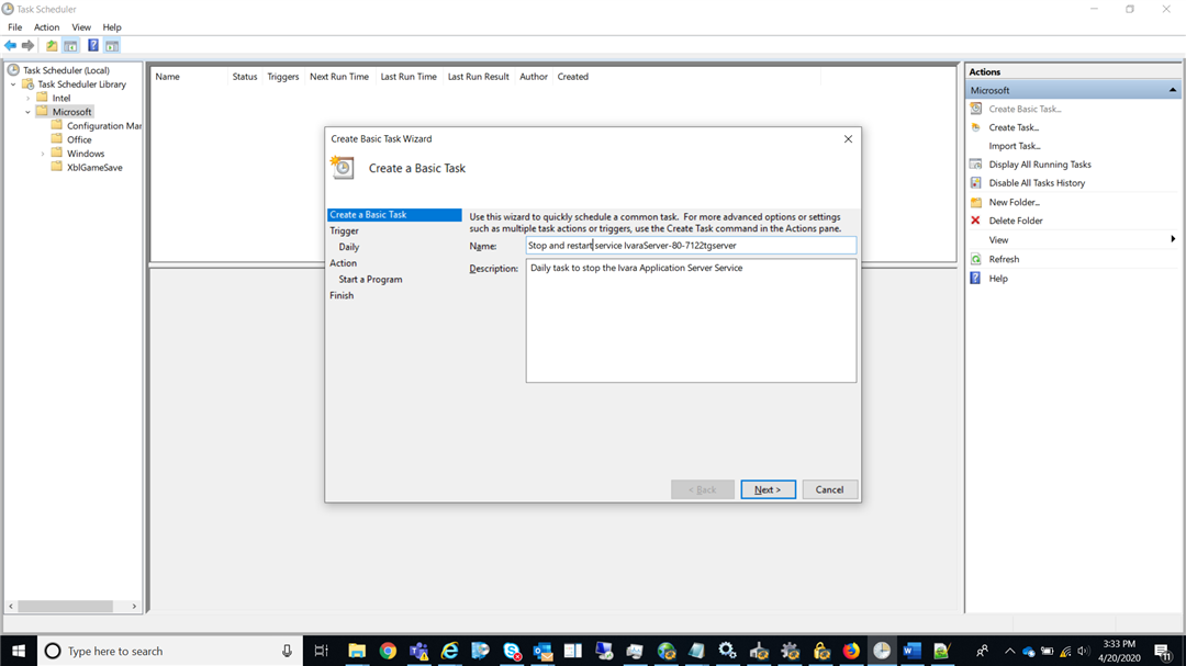

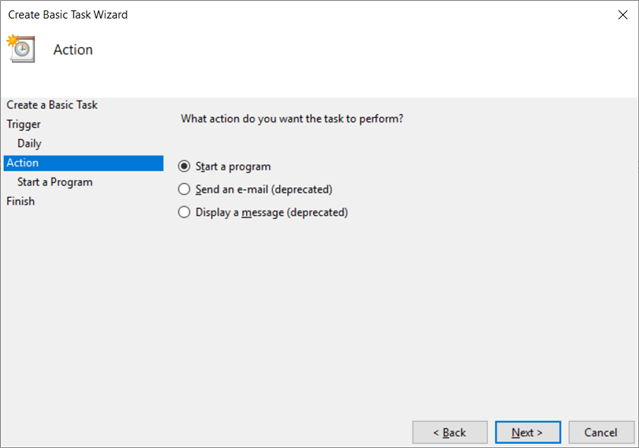

Once the program is created, then set-up a Windows Task Scheduler Task.
3. Open Windows’ Task Scheduler application. In the Actions box (top-left) launch “Create a basic task…”

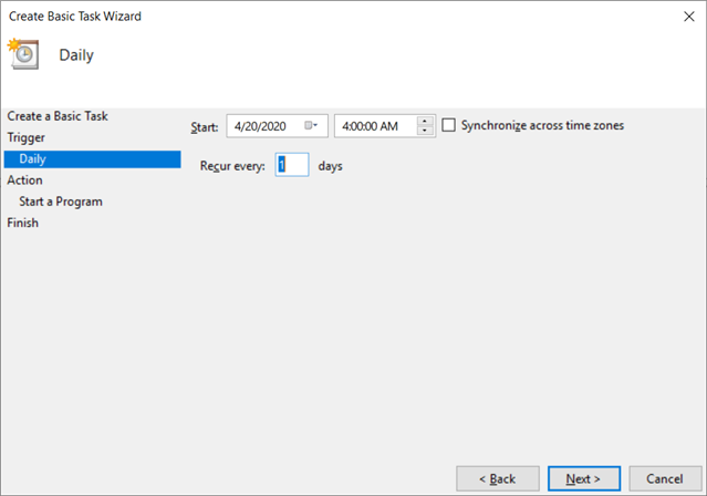

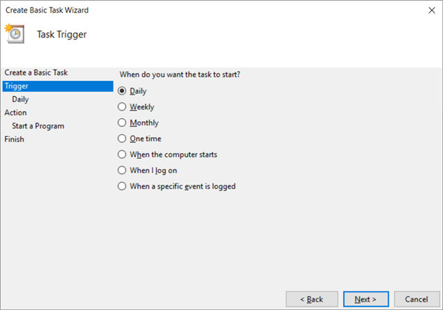

4. Name the task appropriately and select the appropriate frequency, ie Daily and appropriate start time.
Note - be careful not to select a time when an APM service should be running.

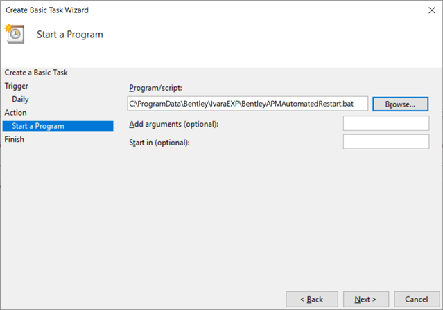

5. Next, choose Start a Program and Browse for the .bat file created in Step 2.
6. Click Finish to complete the Task

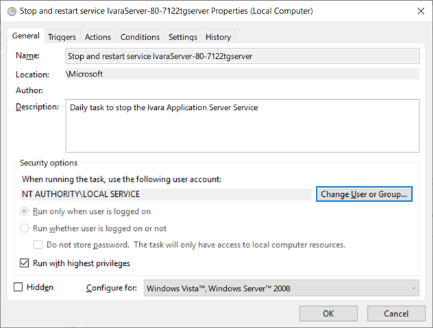

7. Review the task’s properties and set it to run with highest privileges.
