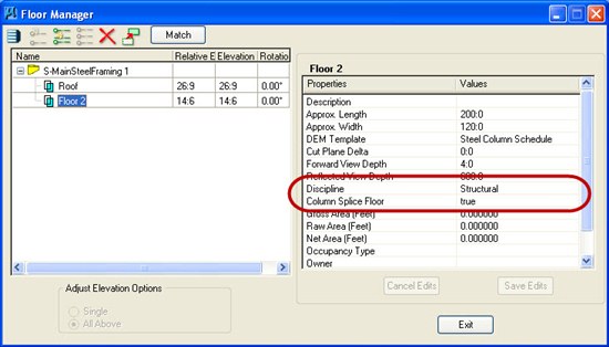

Floor Manager
RSS defines elevations of floors as 'Story Data', in SM floor elevations are defined using the Bentley BIM Floor Manager. Floor Manager floors must be set up in order to export to RSS. The Bentley BIM Floor Manager contains properties for adding splices to columns (see the next section). Note that the RSS story data heights are entered as floor-to-floor whereas SM auxiliary coordinates heights are entered from the origin or bottom floor elevation. Also note in the Automated Structural Drawings section below about how the import process affects the Bentley BIM Floor Manager, creating floor manager definitions from the RSS story data. This can affect other disciplines use of the floor manager.
Columns and the Floor Manager
RSS handles columns on a story-by-story basis. In other words a column that spans several floors will be modeled in RSS as separate elements, one for each floor, whereas SM columns are usually modeled as one element. The Bentley BIM Floor Manager has properties that can allow for splicing columns at each floor during the RSS export operation. Each floor in the Floor Manager contains informational properties including Discipline and Column Splice. Setting the Discipline value to 'structural' and the Column Splice Floor to 'true' will facilitate splicing the columns at the floor heights.

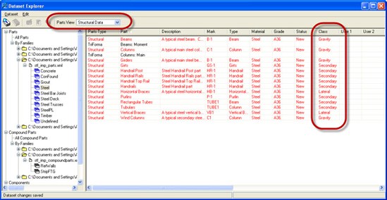

Structural Modeler stores data and member classifications with each member. This data is stored as 'structural data' on the structural elements and is accessed by RSS in the importing and exporting function. Note that is this respect analytical elements need not be present in a SM model to allow exporting to RSS. SM analytical elements have use, specifically in regard to the STADD structural analytical application but are not used in this workflow.
Three properties of the structural data must be present for the structural elements to be read by the export process. These are: Type, Material and Class.
There are specific values for each of these properties that RSS will use. Following is a table of the various types if elements created in SM and how they should be classified. Note that there are only three acceptable Class values: Gravity, Lateral and Cantilever.

 Default values for the type, material and class properties can be set in the DataSet Explorer. One workflow is to set all the beam and column types to gravity as a default allowing the structural engineer to make the choice of changing particular members to lateral in the RSS side. Braces can be set to lateral.

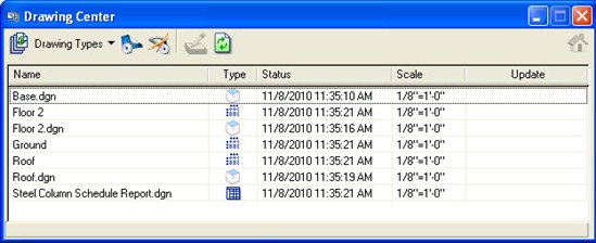

Automated Structural Drawings on RSS Import
Automated Structural Drawings functionality encompasses several related technologies used in automatically generating and updating all of the active project model's Structural Plans, Elevations and Steel Column Schedules. Processing involves using the Import from Analysis Program tool, Structural Resymbolization Rules, Drawing Manager, and Families and Parts together with several new Structural Modeler native Automated Structural Drawings tools and settings dialog boxes.
In order to take advantage of automated drawings the 'primary' file (as noted above) used to model in, export to RSS and import from RSS will also contain the drawing extraction definitions. The 'secondary' structural files can be referenced to the 'primary' model for use in extractions as needed.
Extraction models and grid system models that are generated in the import process are named using the RSS story name. To insure file and model naming standards Floor Manager floors should be named accordingly as these become RSS story data names on an export operation and then the story data defines extractions on the import process.
The Structural Drawing Center is a centralized utility that manages automated Structural drawings generated from the active project model. The Drawing Center is typically used after the import process. It can be accessed from the Drawing Manager task.
