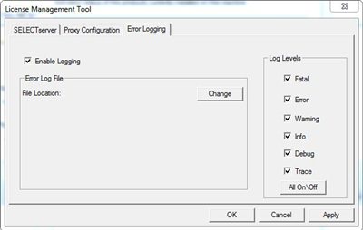

Note: If the SELECTserver is working, and user can open SELECT Server Admin Site and doesn't see any error messages, check from the License Management Tool that the software is using correct Server and Activation Key, and request for the licdebug log. This feature can be turned on from License Management Tool - Tools - Options - Error Logging.
