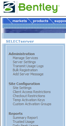

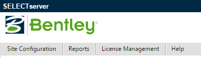

Deployed SELECTserver users who have SELECTserver 09.00.00.xxx will notice the same user interface. Users of SELECTserver 08.11.xx.xxx will notice a redesigned interface. Specifically, the left navigation bar has been moved to drop-down menus along the top.
SELECTserver 08.11.xx.xxx or earlier interface:
SELECTserver 09.00.00.xxx or Bentley CONNECT SELECTservices interface:

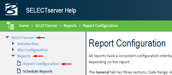

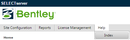

The Bentley CONNECT SELECTservices manual provides more information about the new reporting engine used by SELECTserver 09.00.00.xxx and SELECTserver OnLine. To access it, select Index from the Help drop-down menu.
