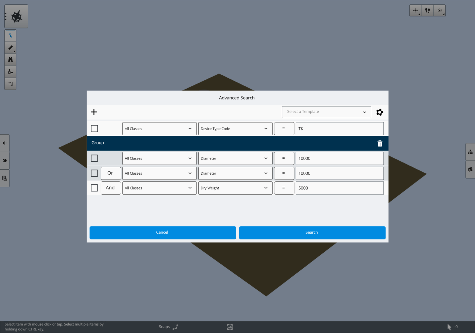

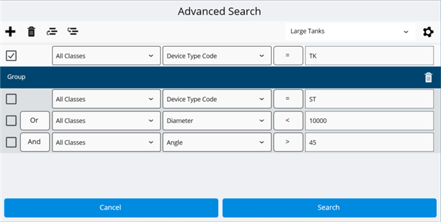

Create Search
When creating a new search, you first select the class in which you would like to search. In the Advanced Search dialog, either start typing in the name of a class or select the down arrow to see a list. When you start to type, the list appears filtered to your text. Once you have selected a class, you can pick a property in the next field. Based on the type of property text or numeric, the next button defines the operand used for the search. The last field is the property value. If you want to add additional criteria select the "+" or add button. You can delete or change the order of your criteria by first selecting it, turning on the check box, and then selecting one of the context tools that appear in the tool bar.
Criteria can be grouped by selecting multiple rows and then selecting the group  button from the tool bar.

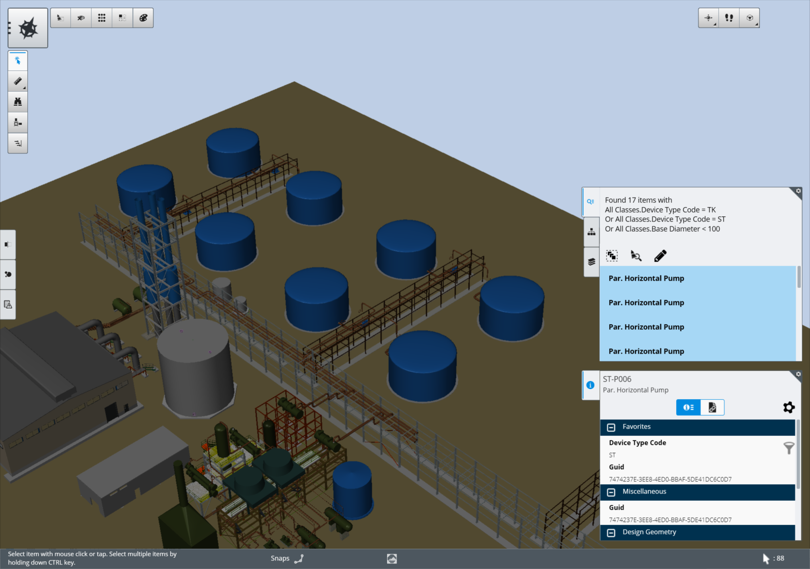

Viewing Results
Your search results appear in the File Browser zone in the middle right in a new tab called Search Results. This tab automatically becomes active even if there are other tabs open in the File Browser zone. All the items are in a selection set for use with other tools. If you want to modify the search criteria, you can select the edit button in the Search Results.
Selecting an individual item from the results list selects and zooms to that item in the view and the Properties zone displays for the selected item.
When finished with the search results, select the clear results button from the Search Results tab.

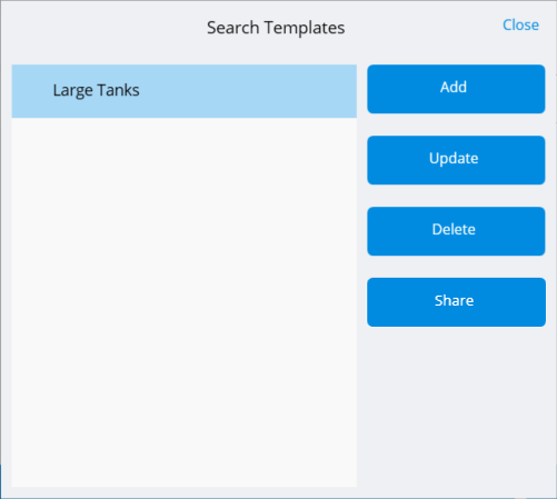

Creating Templates
If you want to save a search for future use, you can create a template. While in the search dialog, define your criteria and then select the settings  button in the tool bar. From there you can create a new template.
Once created, a template selection appears in the search dialog. Selecting a template adds all the criteria stored in the template. You then can search or modify the criteria and then search.
Note: From the Search Templates dialog, you can select Share to share the template with users who are part of your CONNECT Project. Shared search templates can be synced with other members of your CONNECT project by selecting the Sync button from the Backstage Panel.
