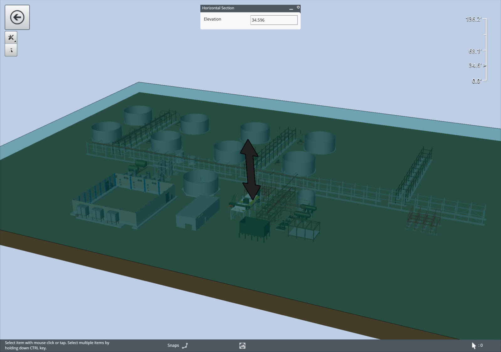

Tools available for a Horizontal section

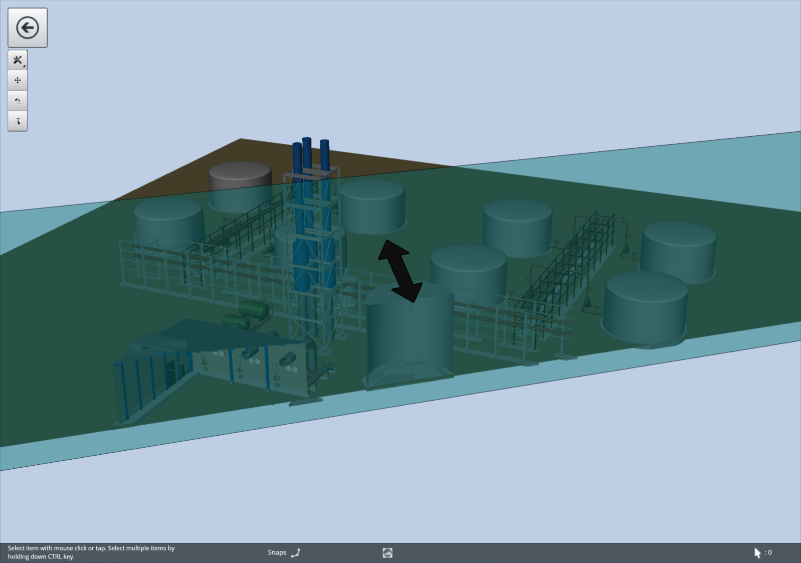

 Tools available for a Vertical section

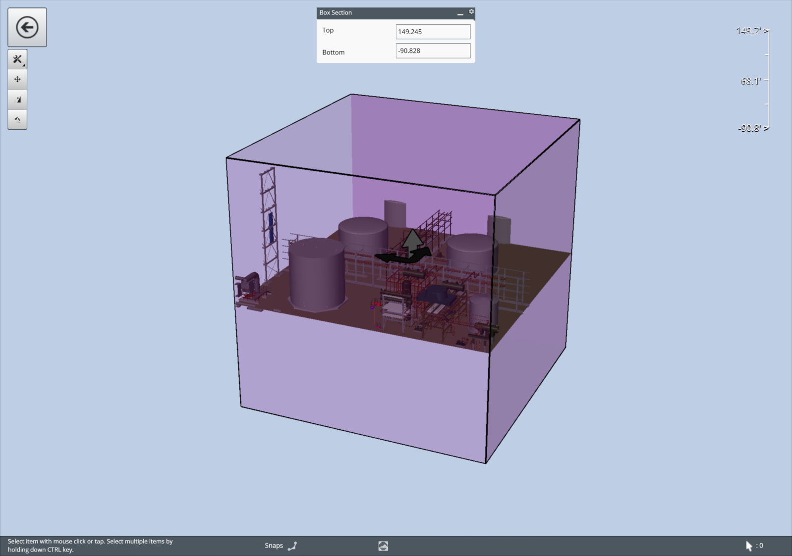

Tools available for a Box section

 Used to move the section. For horizontal and vertical planes, an arrow appears in the section plane that you can drag to adjust the location of the plane. For a box section, you can drag the arrow point up to change elevation or the other arrows move in the XY model plane.
 Used to resize the section. Only available for box sections. Arrows appear on each face of the cube to allow you to resize the box.
 Used to rotate the section. Dragging the arrows in the view allow you to rotate the vertical plane or box. This is not available for horizontal sections.
Used to flip the direction of the section. This is only available for horizontal and vertical sections.
