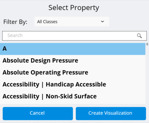

When you select the Add button, a dialog opens to allow you to select a property. This list shows every property in the model. The class of property displays in the brackets after the name to make sure you select the desired property. Once you select the property, select Create Visualization. This visualization finds all unique values for this property and assigns it a color when applied.

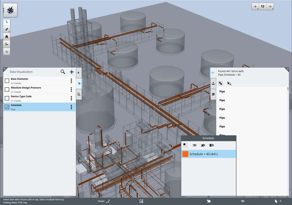

To visualize a Find Similar search result, select an object in the model. From the Properties zone in the bottom right, right click one of the model's properties and select Find Similar. Models with that property display in the Search Results tab of the File Browser zone in the middle right. Then select the Add button from the Data Visualization tab tool bar. You are asked to select a color which will be associated to that search result. Select Visualize to apply the data visualization.

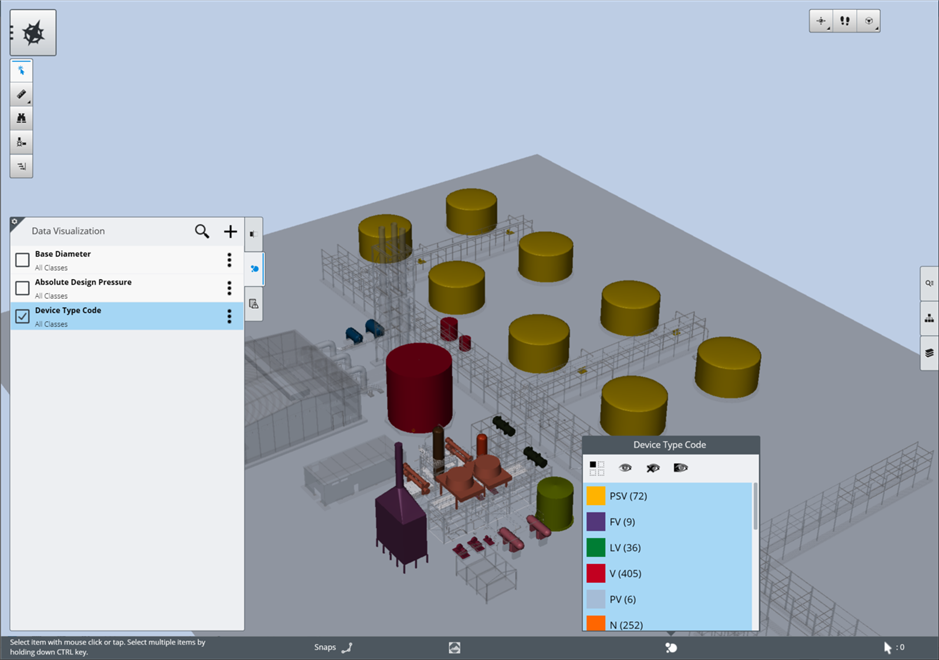

Applying a data visualization is very simple; select the data visualization from the Data Visualization tab in the Content Management zone. The view updates by changing the color of items based on the data visualization selected. Items not part of the visualization display as grey and transparent. A new icon displays in the Status Bar on the bottom edge. When you select this icon, a Data Visualization Legend tab displays the legend that is used to describe the value assigned to the items. From the legend, you can select individual rows to hide those items from the view. From the tool bar in the tab, you can click Isolate to hide all items that are not part of the visualization. You can also select Show All or Hide All to show or hide all the items in the data visualization. To invert the selection of rows in the tab, you can select Invert Selection from the toolbar.
While a data visualization is active, you can use all other tools in Navigator like navigation, measure, sections, or applying a saved view. The data visualization stays active until you select the tile again to turn it off or close the file.
