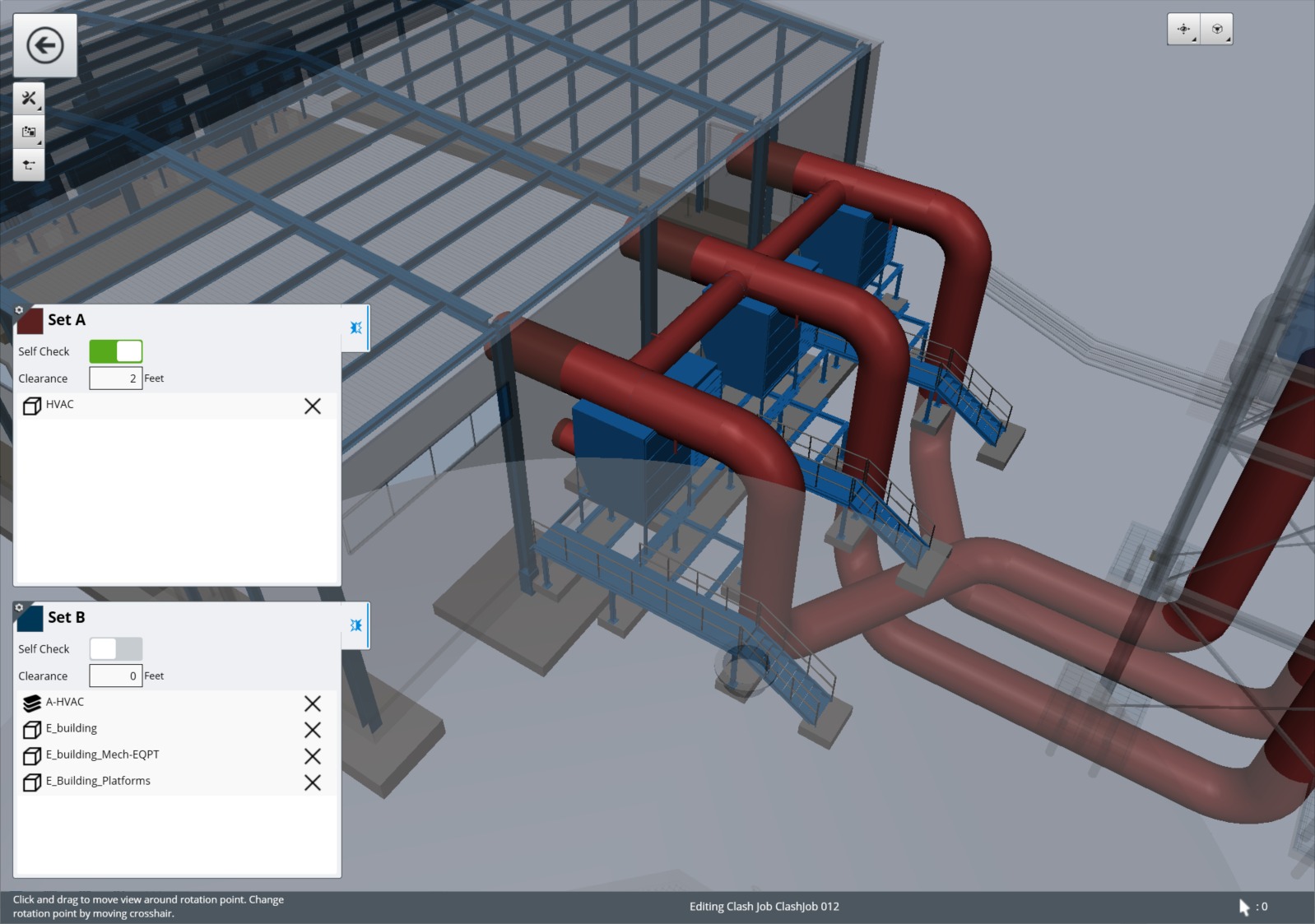

From the Task-based Tools zone, select the Clash Detection  tool. The Clash Detection screen opens. Select "+" to create a new clash job. The Edit Clash Job screen opens. From the General Tools group, you can select Rename to give the clash job a name. You can also select Delete to delete the current job. By default, the clash jobs are named ClashJob 00n in sequential order.
 The properties of the clash job display in the middle left zone and lower left zone. The groups of items are called Set A and Set B. Elements in Set A display in red in the middle left zone and elements in Set B display in blue in the lower left zone. Select Self Check if you want to check a group of items against itself. Change the Clearance value if you want to add extra clearance distance between components.
