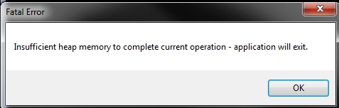

Publishing i-models user may get the following error:
Fatal Error – Insufficient heap memory to complete current operation – application will exit.
Explanation
There are many reasons for this. The most common is running out of memory or software is hitting a resource limit while publishing i-model.
How to Avoid
Option 1
Try publishing larger referenced files separately. In Bentley i-model Composer open single file -> publish to i-model. After you have references already published to i-models then open master file and publish it. At this step Bentley i-model Composer takes existing i-models of referenced file and saves some memory.
