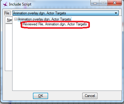

- In the Animation Producer, go to File > Include Script
- The Include Script dialog opens, from the drop down menu, select the option usually called 'Reviewed File......' (see image attached)
- Choose the script and click OK
- From the Animation Settings toolbar, open the Animation Preview Tool to play the animation
Image 1
