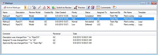

Markups are managed through the Markups dialog, which opens when you click the Markups Dialog tool in the Primary Tools toolbox or when you select Review > Markup > Markups Dialog. By default, the Markups dialog is docked to the bottom of the application window. The top section of the Markups dialog displays information about the markup. The bottom section provides an audit trail of any changes made to the markup properties.

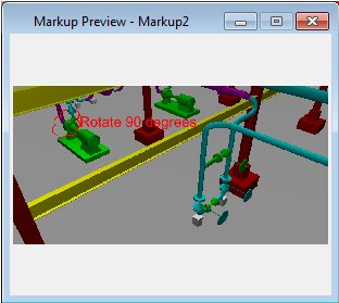

Markup Preview:
