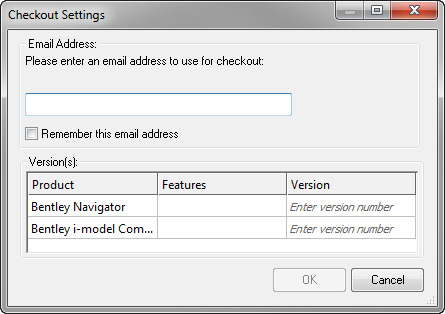

When a Bentley Passport license is checked out, the Select Bentley Passport(s) dialog opens. This dialog is used to select the desired product(s) in the Bentley Passport license for checkout.
The Checkout Settings dialog allows you check out multiple products with different version numbers. Use a Ctrl key pressed and selecting required products from the list.

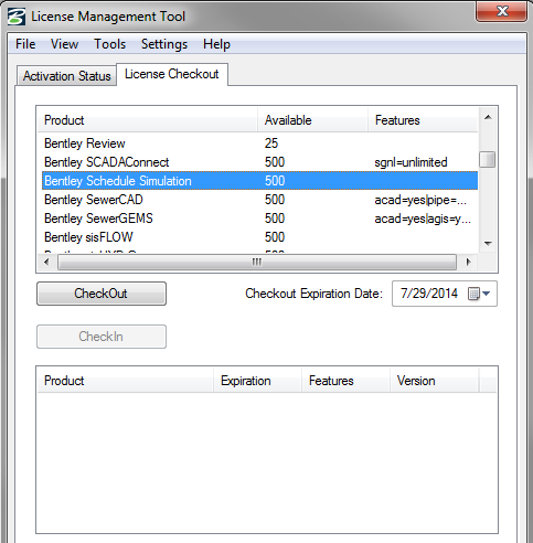

Schedule Simulation and Clash Resolution tools require separate licenses.  Schedule Simulation is licensed with a “Bentley Schedule Simulation Visa” and in License Management Tool user must have available “Bentley Schedule Simulation” license:
and for Clash Resolution user must have “Bentley Clash Resolution” license:
