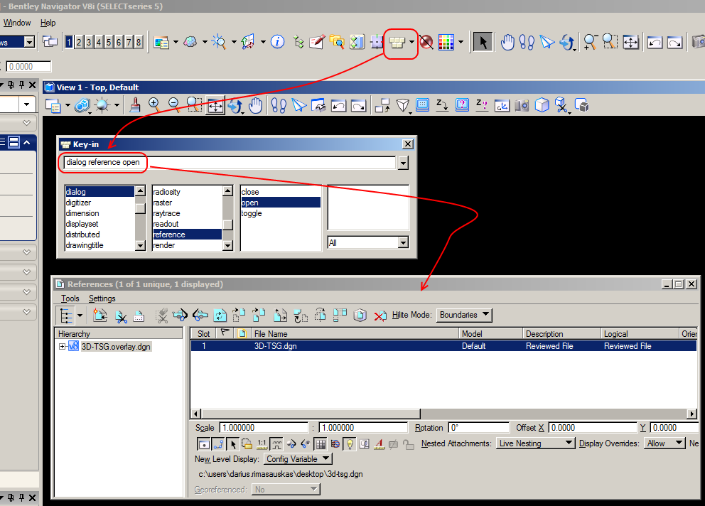

In Bentley Navigator you can control display of attached references using the Project Explorer. However, sometimes you would need to edit other reference attachment settings and for this you would need to open References dialog.
Use Key-in: Dialog Reference Open
